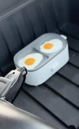

The truck may not have an AC output at all, that's still unclear.
To the contrary, I think it's been very clear, including a video short and the Q & A....
Q: Power outlets? Thinking of work sites and emergency power scenarios.
A: Check your frunk.
Slate Auto Pickup Truck Add-on inverter for V2L Frunk_Egg_Cooker
1,287
1,515
And that photo appears to show a 12v plug. We haven't even seen an image of what kind of outlet will be there. The angle in this one hides it, most images show nothing there at all.
On using the charging port as an outlet, that would depend on the charging connection being designed for output.

I dunno, looks like the top of a 5-15P to me. The top looks flat like the slots of the receptacle are at the top since the plug is flat on top. I found a higher res version:
Slate Auto Pickup Truck Add-on inverter for V2L 1774119070965-la
Those little egg cookers draw 350-400w which puts it in line with what the Maverick can output from its inverter. Not enough to run a jobsite, but enough to charge tool batteries.
2,649
She said (well, strongly implied at least) there will be a power outlet in the frunk that can be used for work sites and emergency power scenarios.
I interpret that to mean there will be a 120V AC outlet in the frunk.

If it were a 12V outlet wouldn't that need about 30 amps to to get to 350-400 watts. Aren't those 12v outlets usually limited to about 15 amps?

OK, the cooker does appear to be a "3 in one breakfast maker" that is on amazon and other sites, available in multiple colors, that is 120v 350 watts.
The plug looks to me like a 12 volt plug though, and I can't find an image of the cooker's plug.
I know I have seen DC cigarette lighter plugs that had that shape, take out the screw in that hole to disassemble and replace the fuse, and it seems too big for a 120 v AC plug.
This could always just be something they rigged up for that one prototype for one time use to show that there will be power in the frunk though.
