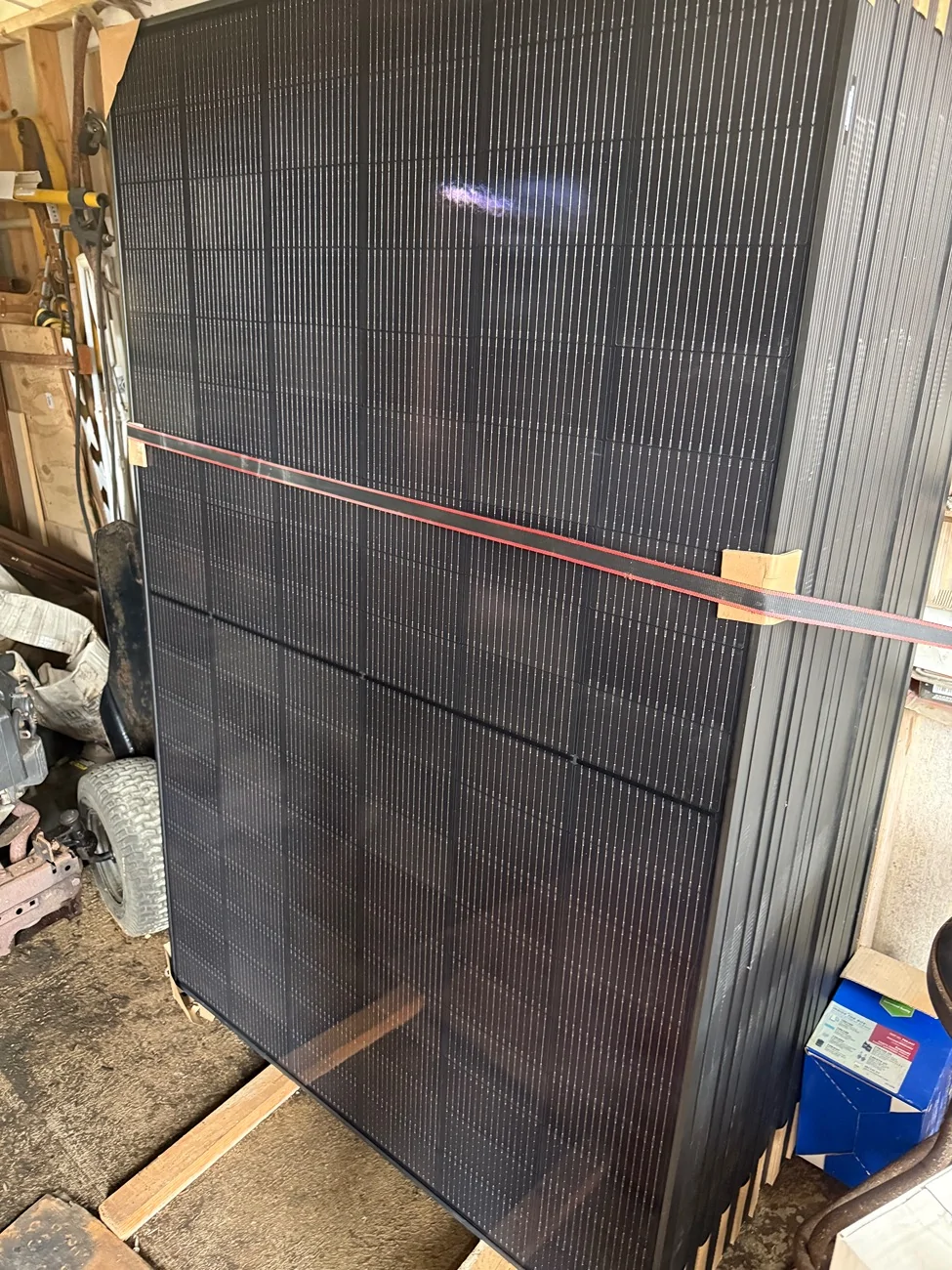

Lol, not installed yet, just placed in shed

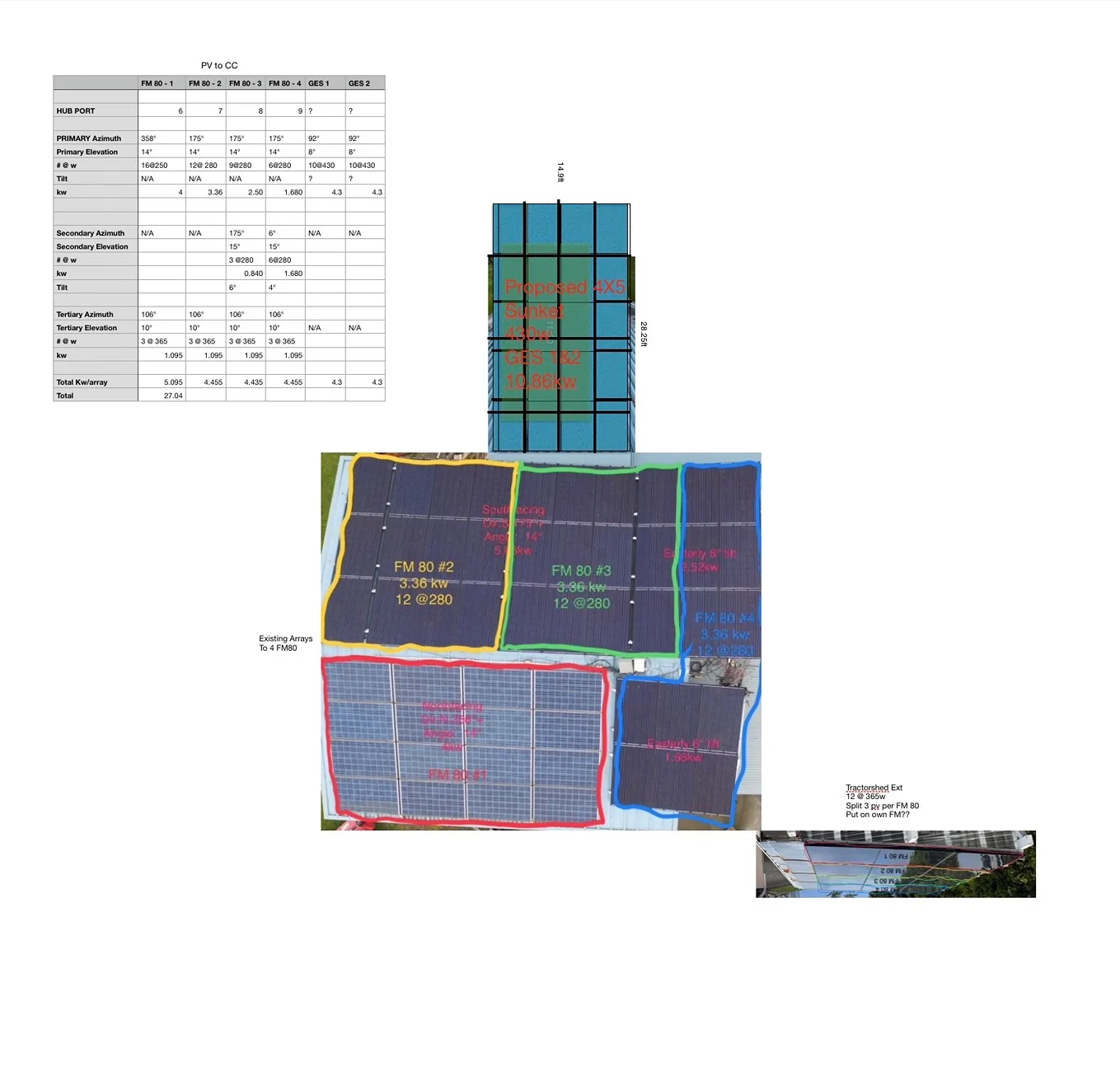

Poor pic, will have to get drone up when done. But the new 8.6kw pretty much takes any viable existing roof on my tractor shed, see top, blue array. Currently have 18.4 kw on the several roof areas at differing orientations. We are 100% off grid. These new panels will tie to its own all in one inverter charger, augmenting the battery charging, but its separate AC will primarily be for daytime Level 2 charging.

As my teenagers would say, "David is kind of GOATED". I haven't met him, but based on his posts, I'd tend to agree that he's living the dream. Well done, Sir.

Are any of those used or are they all new? I understand used modules can be found at great prices and still have lots of life left.

They were all new when I installed. My original install were 125w panels, over $700 each when i got them 2006 and didn’t have a problem reselling when replaced. Contract to the new ones i just got, $190 for 430w.
