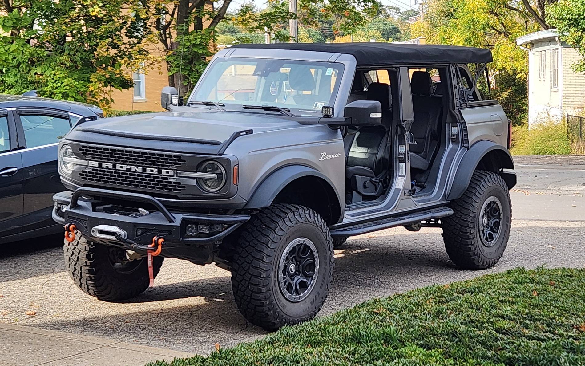

Bronco
Ford smartly mounted the mirrors on the Bronco on the body rather than the doors. With my XJ, the doors were so easy to remove and fit in the back, that I'd often take them off during the day. I kept a 12MM wrench in the console along with two large bicycle handlebar-end mirrors I rigged up to slide into the top door hinge with a spacer and long bolt with a wing nut.
I think PA has since revised it's no-door law IIRC.
Yes PA changed it's law last year. Doors off are fine if the mfg made the vehicle to be able to remove the doors. And yes you still need side mirrors.
IF the doors are removable and IF they offer them, get the mfg door bags. I can't recommend these enough. Makes doors easier to remove and keeps them safe while in storage.

Here is my observations about a door-less Slate. I speak from experience as I owned a '95 Jeep XJ Wrangler for 12 years and I now own a '22 Bronco.
Both of those vehicles were designed from the onset to have removable doors. The Jeep's doors were half-doors with a removable plastic/vinyl window. One nut secured the top door hinge and the door hinge stuck out from the body. The doors had no electrics in them, so no wire harness, no glass, which cuts the weight down significantly. The door check is a simple strap that loops over a hook on the kick panel.
The modern Bronco doors are much more complex to remove. The doors have electric windows and locks, and side impact sensors, so there is a hefty electrical harness. The harness unplugs at the body door frame. The connector has a watertight cover door that springs closed. The Bronco doors have hard-to-access hinges, which makes it a bit difficult to take the doors easily on and off. And the doors are heavy compared to the old Wrangler's doors. Ford thoughtfully molded into the door card a grab point at the bottom of the door to assist in lifting the door off the hinges. The door checks are built into the hinges.
Now what most people don't understand about the Jeep and Bronco is fit-tolerance. Because the doors are designed to be removed, they do not seal as tightly to the body as a conventional truck or SUV. The body-line gaps are wider and the rubber door seals are looser. All necessary to make the door easier to remove and install, which comes at a cost of noise and water intrusion. One of the complaints about Wranglers, and more so Broncos, are the vehicles are loud inside. That is in part because of the is door designed to be easily removed.
I don't think Slate has developed a door design that purposely makes the door easy to remove as the Wrangler and Bronco are. The Slate looks like it has simple hinges, which have somewhat easy access to the hinge bolts, but it looks like the doors are designed to seal tightly to the door frame, unlike the Wangler and Bronco. My observation is the Slate doors will be not be easily removed and how will the crash protection system be affected. The Bronco and modern Wrangler have workarounds built into the crash protection system that recognizes the doors are removed. That's a whole lot more engineering involved than simply just unbolting the door and pulling it off the body.
