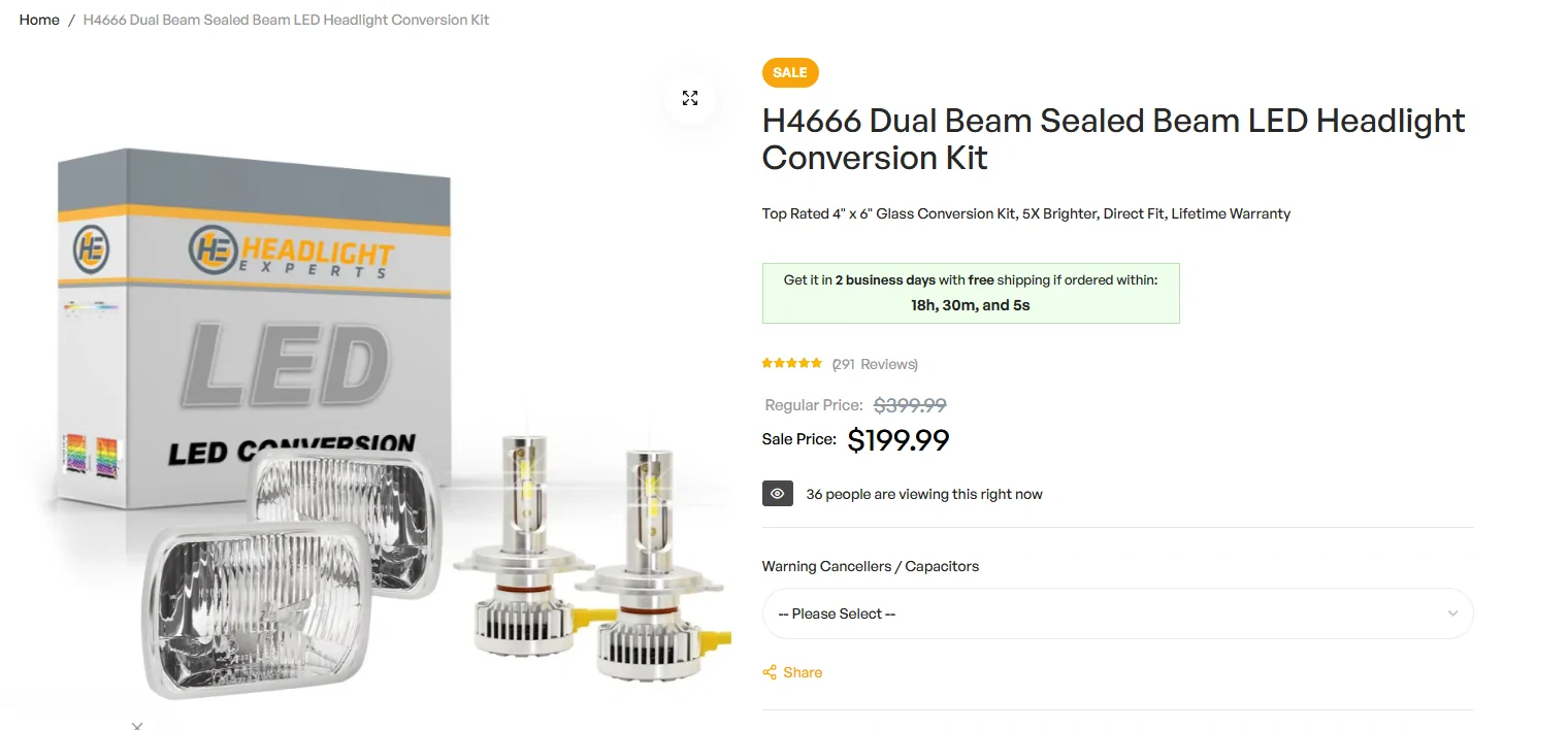

If you really want to convert the Slate to a rectangle headlight there is the Sylavnia H4666 headlight. This is a 5 inch rectangle headlight rated for use as a single headlight per side. It is the size of the old rectangle quad headlights but rated for use as one headlight per side. It was used on some Geo Metro cars from the '90's as well as some Dodge Dakota pickups from about the same time.
You will want to get a pigtail for the lights from one of those cars from a wrecker because the terminals have a slightly different location, so a regular plug for a 5 inch low beam for a quad headlight system won't plug onto the bulb. I had those on my 1993 Geo Metro.
Can't attest to their beam spread but they also sell LED conversion kits for those headlights that mimic the same housing but allow you to put your own LED bulbs in. I'd hope they are designed for the different throw LEDs give, but I've never messed with a set myself. would probably play nice with the current draw expectations of a more modern vehicle.
