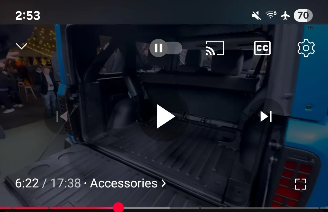

I keep watching this video clip for answers. It appears you are correct, in the standard 2 seat pickup, the rear glass is fixed in place. What looks like hinges are actually covers for fasteners to secure the glass to the roof halo section, not functional hinges. When you install the SUV kit, you swap out the bolts for actual hinges. The lip on the bottom of the glass allows it to be locked in place with the tailgate. So, no latch is needed. Just a lot of fingerprints on your rear glass every time you flip it open or closed.
Makes me curious if someone will make a kit for keeping the hinges on the base-cab model. Imagine the flow-through ventilation you could get with a flip up rear window...
TFL Video
Good catch with that video. It does look like the window is captured by the tailgate. The tailgate "door card" looks to be swapped out as part of the SUV kit. And I caught a glimpse of the lower ball stud finally, which indicates gas springs will hold the window up. Which now poses the question as to how the upper ball studs for the gas springs attach to the window glass. On my Bronco they are glued to the glass. But with my Bronco, there is a whole lot more seal material to keep the tailgate/glass water-tight.

Slate Auto Pickup Truck How does that rear window work on the SUV? Screenshot_20260303_145318_YouTu
