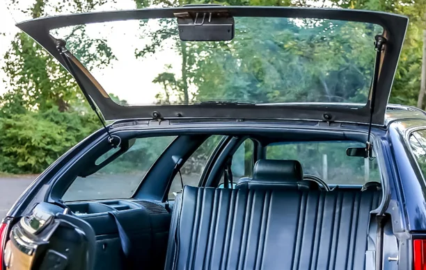

I was looking at how some other OEMs did their 'full-glass upper half' rear hatches and it seems like all of them have just the latch on the glass and the entirety of the locking mechanism built into the tailgate. I hope slate is looking at how to get that integrated into the drop-down tailgate.
It'd be as easy as drilling two holes into the glass for the through-mount of the hardware as long as they have a way to get a lock in the tailgate... that won't be used in the pickup mode. I was looking to see if I could find a pic of the tailgate down so we could see if there's any access panels on the top for future latch hardware.
Both of these examples require the window to be up to use the lower tailgate, unlike the Slate prototypes.
1st Gen Honda CRV:

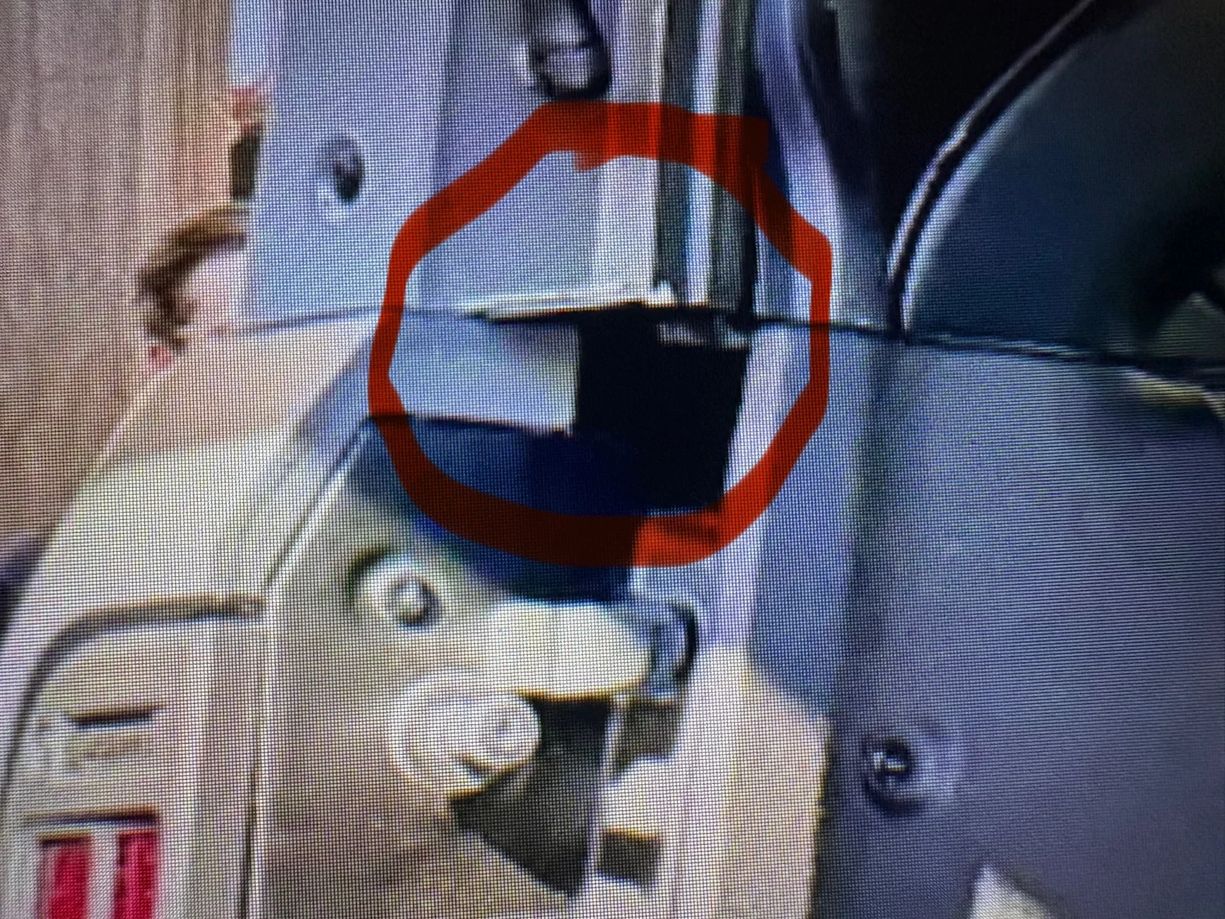

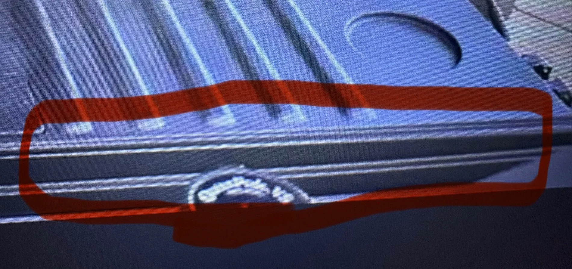

We have a Leer shell on an old Ford F-150. The back window has 2 latches that you turn, then lock. You have to open the glass before you open the tailgate, since the glass seals on the outside. I was wondering if the Slate might have the glass on the inside of the tailgate. If you notice there is a notched area on the tailgate toward the inside of the bed. So possibly the glass closes on the inside of the tailgate, you would close the glass first, then close the tailgate. I’ve tried to circle the areas on the SUV that I am talking about. There is the notch on the top of the tailgate on the inside, and it looks to me like on the sides of the top, the glass could be closed inside the tailgate . You wouldn’t need any latches on the glass, and then you can lock the tailgate to lock the top. Our Leer top has 3 latches, the way I am thinking, the Slate would only use one latch, and only one place needed to lock it.

Great point, keeps the cost down by designing a channel/step into the top of the gate. Put some weather stripping on the bottom of the glass to keep out water....

The Bronco has a similar rear glass hatch set up as the Slate's SUV kit. The locking, swing-out Bronco tailgate captures and locks the glass from opening. The glass hinges mount at the top via through-holes in the glass with button bolts. The gas struts mount to the inner glass surface on fixtures glued to the glass. The bottom of the glass has an elaborate plastic fixture that contains a highly contoured rubber seal and serves as part of the mount for the rear wiper, also glued to the glass. The rear glass includes a heating element and washer spray nozzle.
It looks like Slate intends to lock the SUV rear glass with the locking tailgate.
