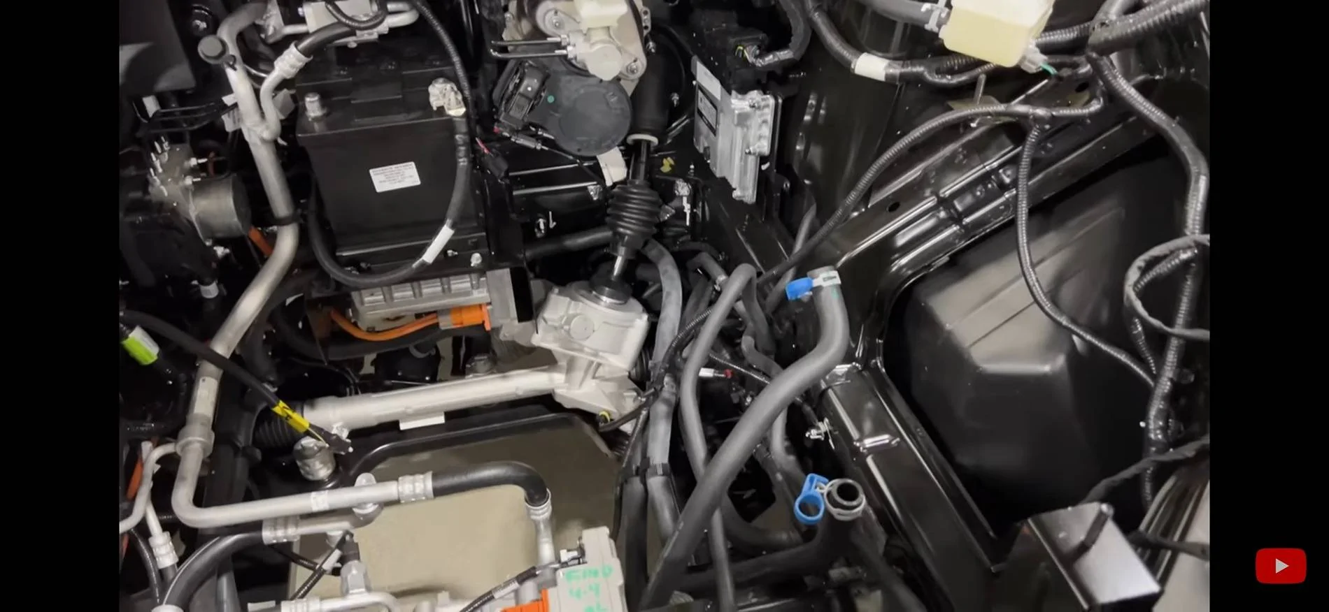

I'm not sure why there isn't just a converter, cost I assume. Lucid still has a separate 12 v battery. I asked Slate Auto, and there is a 12 v battery in the frunk. You can see it in the Munro video in the center of the firewall, but I think it is now located on the passenger side.
105
113
DC to DC converters produce an AC ripple that can be dampened by a battery.
Also, the DC converter would have to be on all the time which means it would increase the standby loss. Meaning your battery would drain faster just sitting there.
Having a buffer battery let's you store power so you can turn off everything so standby loses are much lower.
On the side of safety, if the converter died while on the road you would instantly loose all the 12v systems where with a battery you would have some warning.
Could you make a converter system work? Probably, but like you said, it would be more expensive and complex.
