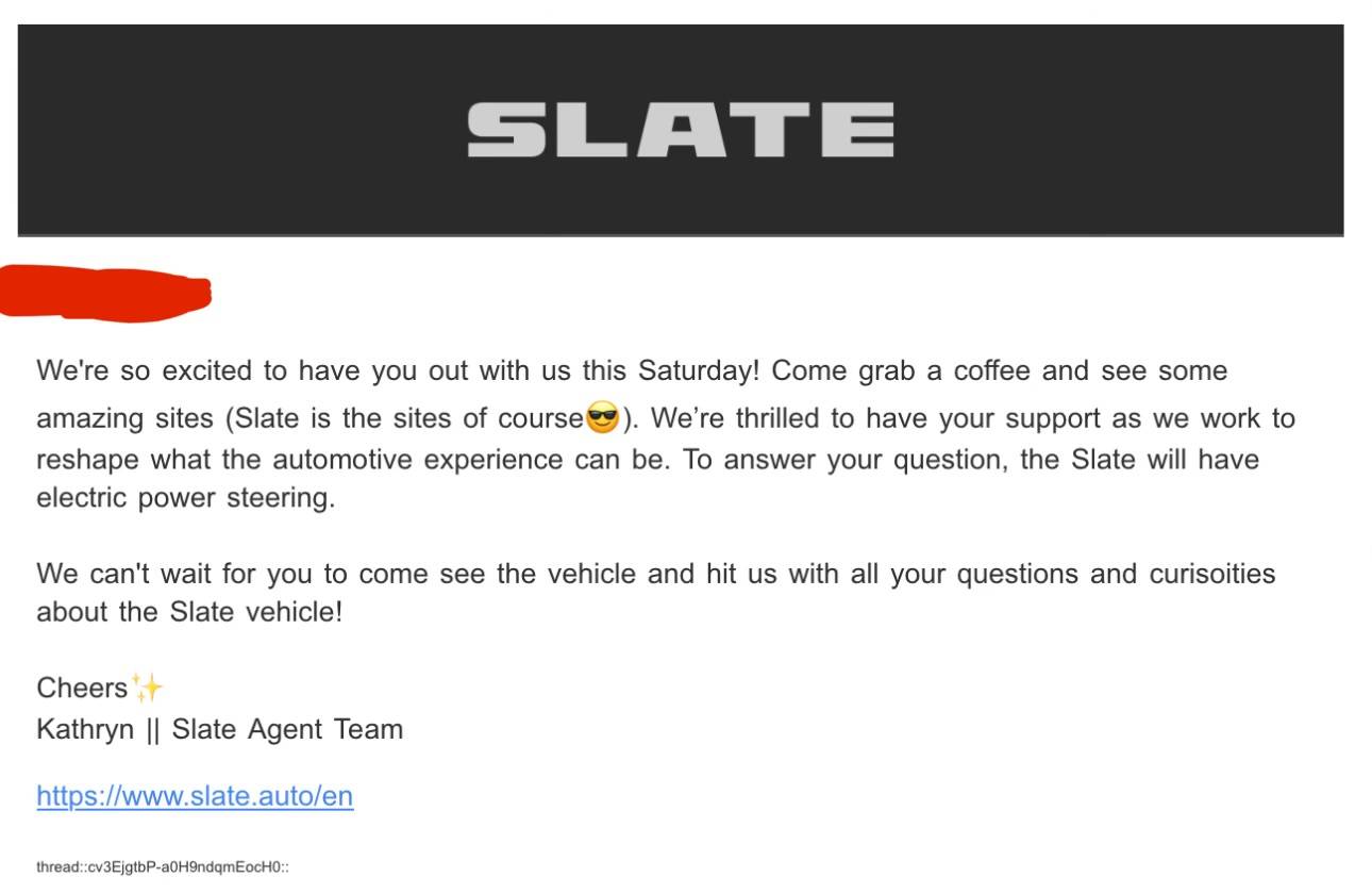

I reached out and was told it will have electric power steering. I explicitly asked whether it was EPS or hydraulic, so here’s hoping it’s full EPS

Dorbiman: Thanks for the confirmation that the rep misspoke. I too sent a similar question and just received a similar reply.
