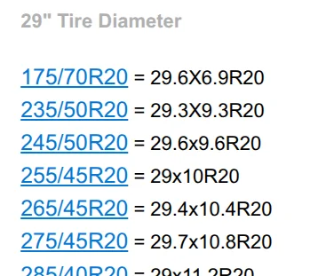

I don't know what you know, you may already know this information, but this response is my interpretation of your question....
Simply, you try to stay with the same overall diameter by adjusting tire size for the 20s so the stock data/performance remains relevant. Less hassle too switching between. I think all manufacturers stick to this principle when rim sizing varies between trim levels.
Stock tire size is 245/65/17 which is 29.5 inches. Rim 17", tire height at each end 6.29".
An easy example, you get a new 20" diameter rim with the same width as the stock wheel so you have two numbers figured out, 245/x/20.
An online calculator makes aspect ratio guesses easy and the new tire size should be 245/50/20. Tire height on each side 4.82".
Unsprung weight may be harder to evaluate. Pros and Cons to making the new set lighter or heavier?? Lighter probably applies also to EVs/regen.
Tire grip is another consideration.
Personally, lighter aftermarket 17" wheels with "similar width and offset," and reuse the tires as my first learning experience with an EV.

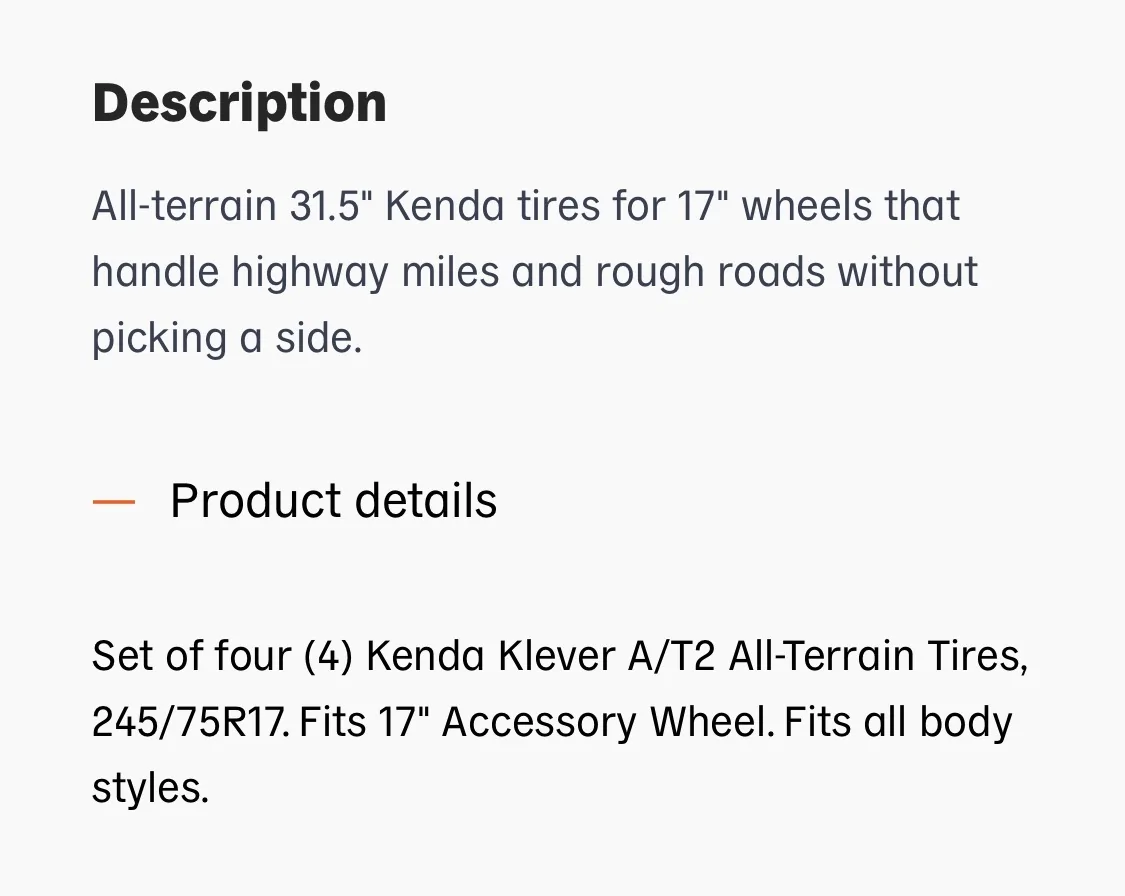

There’s been talk about the necessity for an update via the app or otherwise since a significantly taller tire is offered as an option. The A/T tire Slate is offering for the 17” wheel is 49mm/2” taller than stock.
