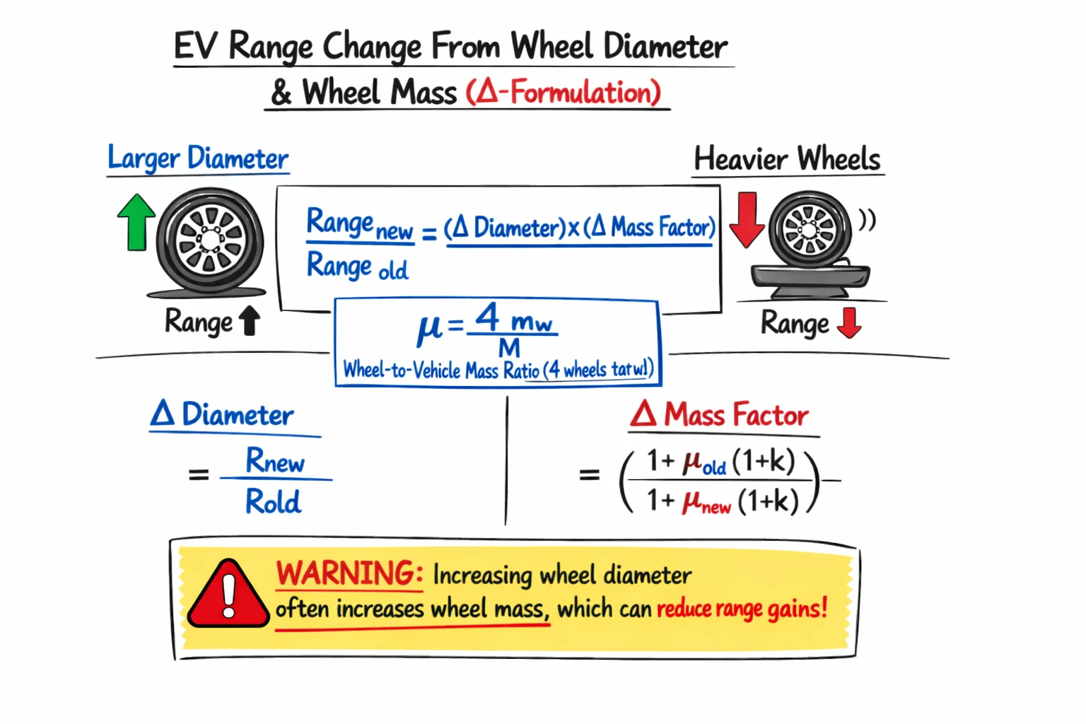

You can use some simple physic to get an idea of range impact. I admit to using CoPilot to help me whip this up.
Slate Auto Pickup Truck Range vs Wheels size 1782683285631-qc
It is very simplistic.

I don’t think wheel diameter will have a great effect on range. Motors have a pretty flat efficiency curve, so it shouldn’t make a big difference.
Bearing friction is also fairly non linear, so it will be hard to predict.
I’d put money on tire selection having the greatest impact on range, but due to the compound and tread, not the diameter.

Part of the issue is you are increasing the energy bound in the heavier larger diameter wheels. This makes more city stop and go less efficient for EVs, But you could get a better highway efficient where the increase in overall wheel radius may help against, presuming that is not defeated by the added mass of larger wheels.
