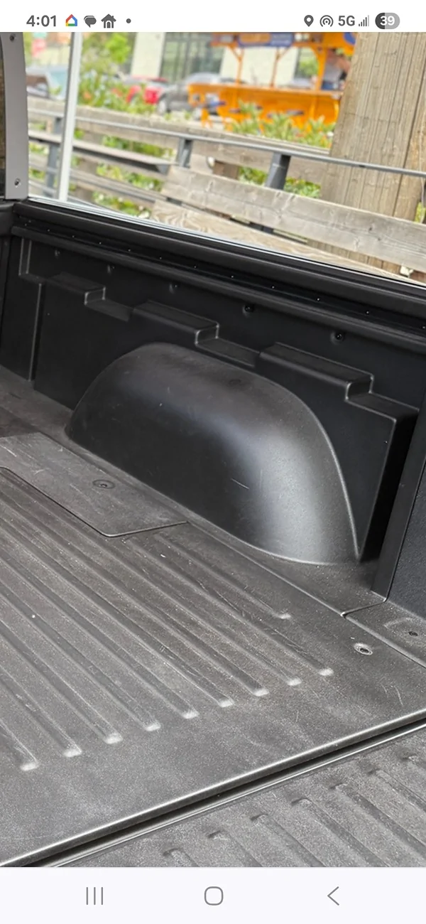

Wouldn't they crack without support in the middle? Slate has an easier solution. Use your own 2x4 braces.
I was expecting the tailgate to lineup with the 2x4 supports in the bed of the slate.
With the Maverick, the fenders are designed differently, and we just put a sheet of plywood in before the drywall, worked great.

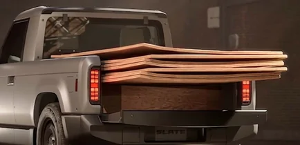

4'x8' plywood doesn't fit between the fenders, so....
Yet. They told me at the Olympia event, and someone here was told at the NYC event, that they're working to widen the fenders to allow 4' wide sheets to fit on the deck of the bed directly

Glad that they know that is a minimal Home Depot requirement.

It definitely wouldn't be a deal breaker for me regardless, as they've made it easy enough to stick a few 2x's in the bed to support the load. But if they're going to do it I'd happily take that outcome

As a trade-off that would restrict maximum wheel-and-tire width.
Seems fine the way it's shown now.

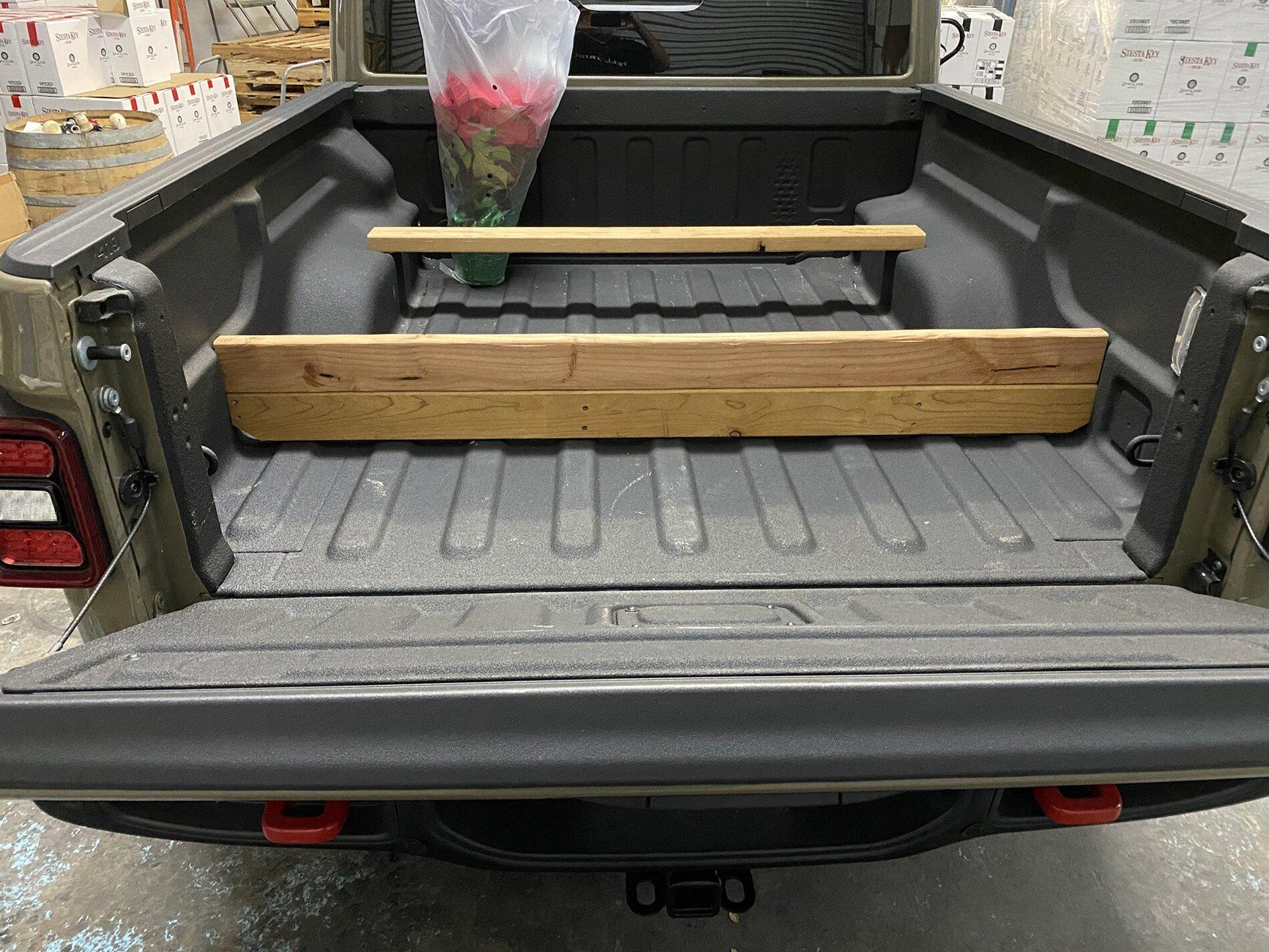

My Gladiator tailgate just has a hook that you put the tailgate cables behind. That puts the tailgate at the top of the wheel well. It also has a cutout for a 2x4 across the bed and 2 - 2x4s or a 2x8 behind the wheel well for another support point for plywood. Very simple and effective design. I would be disappointed if the Slate didn't have something as simple.

You're right! That is pretty cool way of doing it.

That would be easy!
