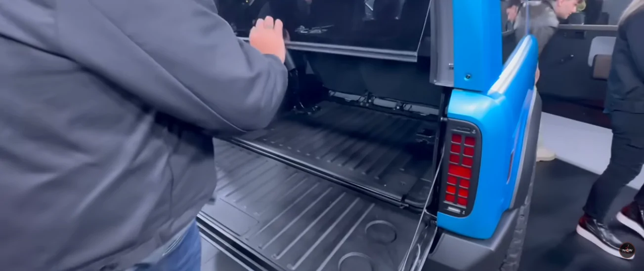

The problem is Slate has indicated for the square back at least that the "halo" rear of the cab transfers to the rear of the SUV top. The cab rear glass has no latch mechanism whatsoever based on all the images thus far posted by Slate and people who have attended Slate reveal events and posted pics. It makes sense that the cab rear glass has no latch because it is safe to assume it is fixed in place and does not swing open. So, the problem lies with if the glass is reused, how will it be locked with the SUV kit. Adding a latch mechanism either means the latch hardware will be glued to the glass, or the glass will need to be drilled to affix the latch hardware to the glass. Or the tailgate top rail will be modified (or is already designed) to lock the glass in-place when the tailgate is closed, which makes the most sense. The Smelly Hocky Bag video just confused the issue.

I keep watching this video clip for answers. It appears you are correct, in the standard 2 seat pickup, the rear glass is fixed in place. What looks like hinges are actually covers for fasteners to secure the glass to the roof halo section, not functional hinges. When you install the SUV kit, you swap out the bolts for actual hinges. The lip on the bottom of the glass allows it to be locked in place with the tailgate. So, no latch is needed. Just a lot of fingerprints on your rear glass every time you flip it open or closed.

That they did which shows the window opens independent of the tail gate
And that's one neat trick sealing the window to the tailgate when that's done
Guaranteed leak in the rain/car wash.
