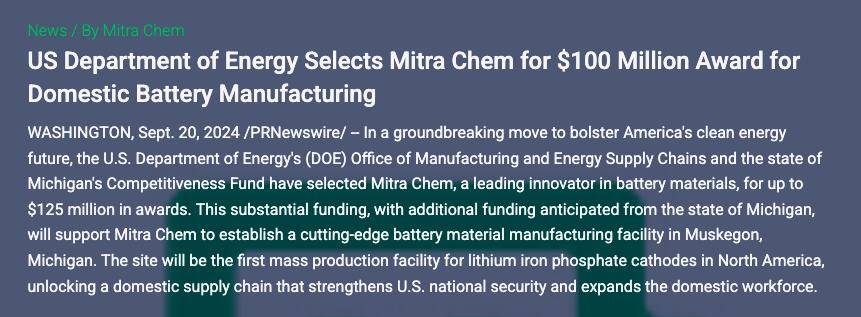

Shot:
Our cathode products are applicable to multiple customer segments, and have spurred multiple commercial and sampling engagements
LFP Industry Standard
LMFP Differentiator
LMX Breakthrough​
Chaser:
Slate Auto Pickup Truck LFP Battery Chemistry Mitra_Chem_News

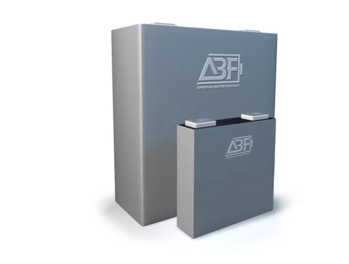

And here's another, right here in Arizona. American Battery Factory (ABF) in Tucson will hopefully be coming online sometime in 2025. I think their initial product will be prismatic LFP cells for solar storage applications . . .
https://americanbatteryfactory.com/press/2024-03-18-abf-partners-with-lead
Obviously, these are also excellent EV batteries. Slightly less energy dense than NMC, less prone to thermal runaway if something goes wrong, but very durable when needing to cycle from near zero to 100%. The only thing one has to be concerned with when choosing LFP is they don't like being charged when the ambient temperature is at freezing. Thermal management in an LFP pack that needs to live outside would typically include cell heating of some sort. They actually work quite well in high heat, up to around 140° F without issue.
Slate Auto Pickup Truck LFP Battery Chemistry ABF-batteries

Mitra Chem (the company in my Shot/Chaser post) makes "cathode products", which I think are what goes inside cells, not the cells themselves.
I should have been more clear about that.
Chamath Palihapitiya, one of the four venture capitalists who are on the All-In Podcast, is on the Mitra Chem board. Chamath is a smart cookie! He thinks we need domestic sources for battery materials so he did something about it. đź’Ş
