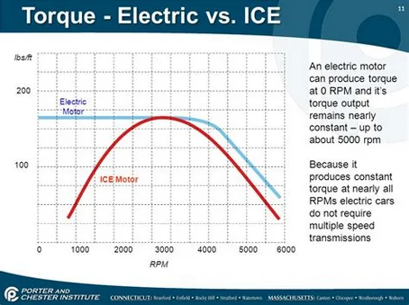

The Truck's (horse)power-to-weight ratio is pretty good.
While electric obviously has a torque output advantage compared to naturally aspirated ICE because max output is always at throttle tip in,
This is an important "feature", Jackrabbit Starts and all....
Comparing Peak Torque numbers from ICE and EV is misleading because the torque graphs are different. I searched the picture field for an illustration and found this:
Slate Auto Pickup Truck One thing I think might hold Slate truck back. EV_Vs_ICE_Torque_Curves
