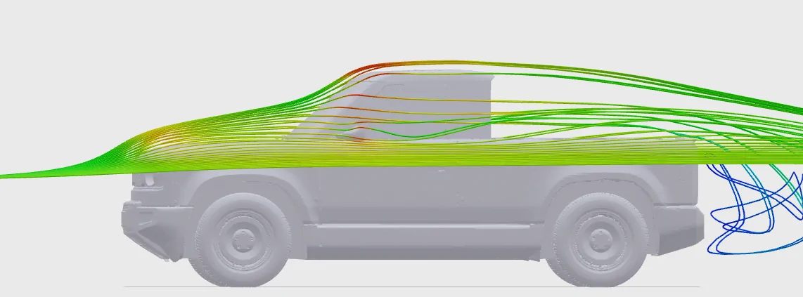

To be fair, a 0.39 Cd is atrocious.
I mean, it is a truck, so that is kind of expected, but other vehicles I have experience with that do very well, like my Audi A6 E-Tron both has a 0.21 Cd and a smaller frontal swept area.
Because of this it gets about the same range on the highway as it does around town.
The Slate Truck- however - I'd expect will do pretty well around town at speeds of 45mph or below, but that the range will drop like a brick on the highway due to the drag.
I'd imagine in SUV configurations, especially the fastback configuration, the Cd will be a bit lower, and in that configuration it will do better.

Wondering if adding a tonneau cover on the pickup will improve the Cd? Or not that much?
mattlach
May 25, 2026
Boston
Audi A6 Etron Quattro, VW ID.4 PRO S AWD.
I'll fully admit that while I am an engineer, I am not that kind of engineer. Aerodynamics are not my specialty by any stretch of the imagination, so I am more like a well read layman than an expert on this topic.
That said, at speed, I suspect a tonneau cover might help. Nowhere near as much as a fastback body would, and probably nowhere near as much as the marketing materials from the tonneau cover manufacturers claim, but I think it would be at least slightly beneficial.
Educated guess is that adding a tonneau cover would reduce the Cd by maybe 5-6%. In a gas pickup truck that probably only results in a 1-3% mileage improvement as drag is only a part of the resistance the engine has to overcome, but in an electric one, where drag is the primary source of resistance, you might just get that full 5-6% back in range when driving on the highway. It's not a lot, but it should help.
I imagine it'll be a pretty small difference with the short bed and the spoiler they added to the cab. Even on full size trucks it has a minor impact.
Slate Auto Pickup Truck Range predictions Streamlines
2,064
2,809
A tonneau cover or SUV kit may actually lower range. See the mythbusters episode on the topic for a simplified explanation.
Slate put a lot of sim time in before they even made the prototypes to optimize aero, while staying in the constraints of looking like a truck, that may make a bigger difference than on that truck mythbusters used.
