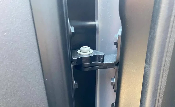

I’m interested in removing the doors from time to time, in pickup form and maybe open air, I’ll need to find a way to put a side mirror on the drivers side, it appears in Minnesota I probably won’t need side mirrors but would feel better with a drivers side

I found this image here on the forum but it's from last year.
Slate Auto Pickup Truck Removing Doors door
If they still work like that, when you take the bolt out, the hinge on the truck will have a hole in it. Do what I do with my Jeep, get a Harley mirror and stick it in that hole.

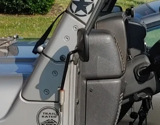

On my Jeep wrangler, I used the largest bicycle bar-end mirrors I could find. Required a bit of modification to fit into the hinge mounting, but using the small mirrors let me store them in the center console.
Got any pics of your set up?

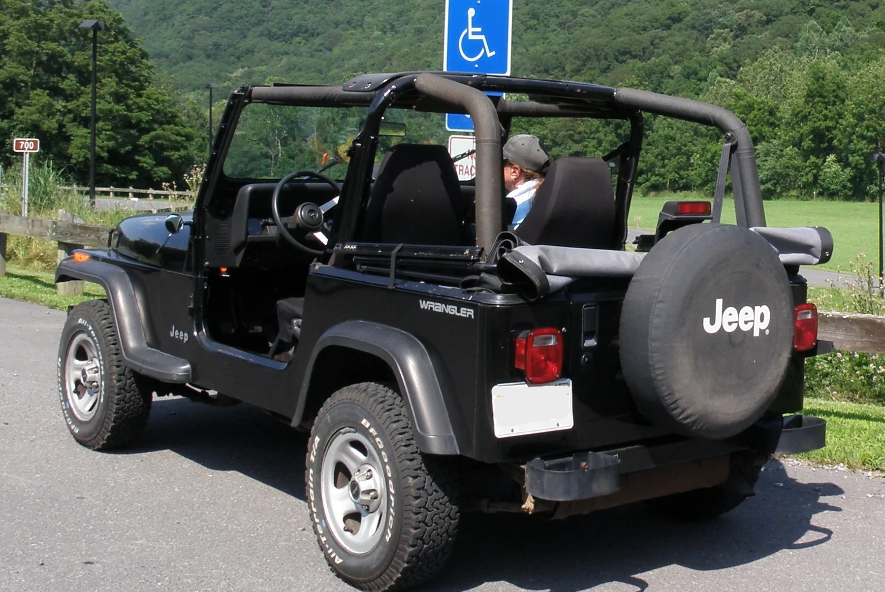

I'm amazed I found a pic; the best I have of it circa 2008 - LOL. Wish I had a closeup to show the mounting detail. I did the hack some time back in the late 1990's. We were at the beach and took the doors off. I was worried one of Delaware's finest would pull me over, so I went to a bike shop in town and bought the biggest mirrors they had. Then to a hardware store and bought a hacksaw blade and two long machine screws and wing nuts (a serious in-the-field hack truly - LOL). I cut up the bar-end mounts. Some time later I cut bushings on a lathe at work so the mount fit in the hinge tighter. Worked great.

Well, I do live in Virginia...
The YJ Wrangler lets you remove the doors and they'd fit in the back. I kept a 12MM wrench and the mirrors in the center console, so anytime we saw fit to pull the doors, it was a 5-minute change. The Bronco I now have... not so much.
