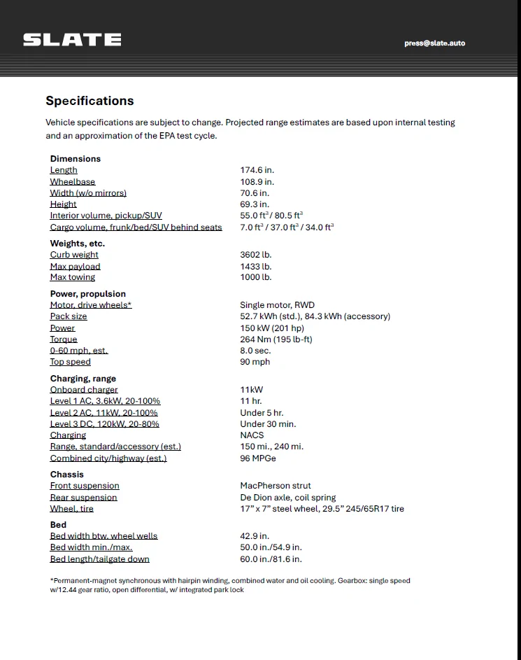

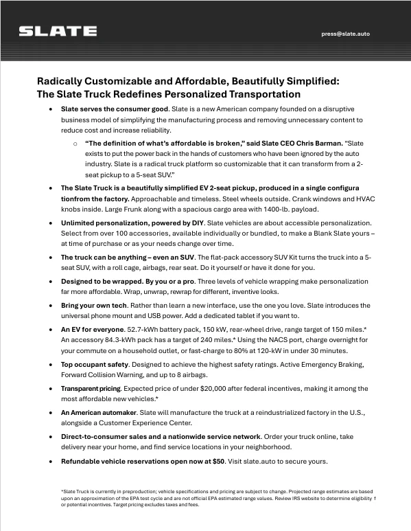

In case you missed it, here is a handy spec sheet of the Slate truck with weights, dimensions, payload, charging, and performance. I printed this out and laminated it for easy reference.
It's actually posted on their website, if you know where to look... *

Ground clearance? And I didn’t get any indication from the press release video, but did they explain why the dismal towing capacity? 1000lbs isn’t even a small boat and trailer, barely a motorcycle and trailer. I don’t see 2000lb as being difficult with this unibody construction. Also no AWD option on a pickup/SUV? By the time these specs improve will
The price be 37,500 before incentives?
I suspect the low tow rating has mostly to do with the power output which is very low compared for many other EVs. The other part might be cooling, either motor, or battery
