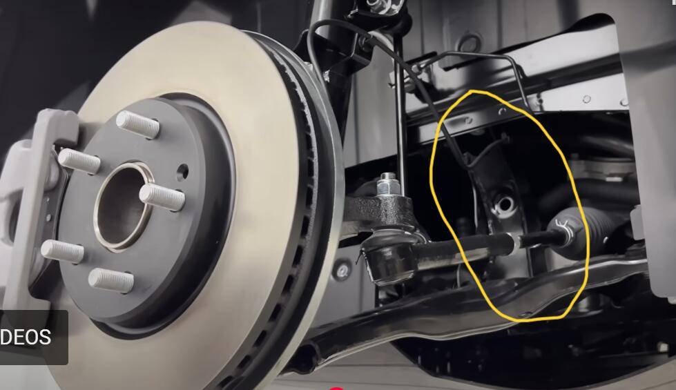

While watching the Munro video, I noticed the battery had three connectors, one for the charging, and two others. One of those is for the engine, but is there an extra one for an extra motor?
596
955
Watching the Munro video it seems like the front suspension has the space for the CV shafts, and they have a void under the frunk that everything seems to go around or over. The wheel hubs do lack a spline, but they are simply bolted to the uprights.
I think the platform is designed to have a small front motor but I doubt they plan on having a kit to install a motor.
I would guess it's leftovers from previous engineering when they decided to omit the front motor option or it's pre-planning for a future model that will share the same platform but have AWD.
The big tell will be if they have plugs at the front of the battery pack for the front motor. So we'll see.
KJRaven
165
305
I made the same observation several weeks ago when a prior video was posted here and noticed the steering knuckle seems to be designed to accept a halfshaft for a front drive. The Munro video shows the knuckle a bit more in depth and what I thought was an opening for a halfshaft it now seems more related to the bolt-on wheel bearing design they chose. It is a great design for the front wheel bearing as it makes for easy replacement if the bearing goes bad; one of my cars uses the same design (and can be had in AWD). But from the Munro video it seems there is a frame member in the axis of where a halfshaft would need to go to reach a central motor located under the frunk. It's hard to tell from the Munro video the geometry of the frame member if it is indeed in the way.
after watching the monroe video I am less confident that it will be an easy swap... a lot of the equipment under the frunk would need to be relocated. It is probably technically possible, but not probable. I dont need more than 2wd anyways so im not too disapointed.
2,152
3,045
Yeah, it is hard from the video to see how things line up. It does look like a motor can fit in the front and eat up some (most) of the frunk, but how it aligns with the front axle axis is hard to discern. And I agree with you, I just need 2WD too. Front-drive adds a bunch of weight and consumes more power from the already small battery. It affects the steering gear, steering geometry. A whole bunch more engineering.
And that engineering can wait until current model production is running smoothly, focus on that. I can adjust to RWD only.
