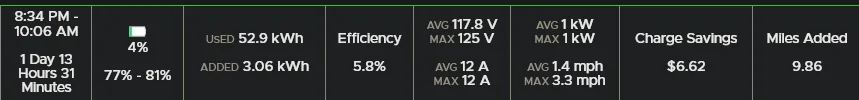

When you charge, the vehicle is "awake" and burning more electrons to run the BMS, coolant pumps, charger, and other systems. When you charge at a super slow rate like 120v @ 12A, all those systems have to stay online longer which wastes energy. This is especially pronounced in cold temperatures where the car might be using all the energy to heat the battery and not have any left to put energy into it. I charged my Model S at a friend's house back in 2019 on a 5-15R in his garage. It was raining and around freezing, and I got almost nothing added to the battery:
Slate Auto Pickup Truck I think I am “over The Slate” 1773911196109-q8
To be totally clear on the numbers, I did sleep in the car overnight which obviously used energy not tracked here, but during the day I saw the battery climb by about 0.8% / hour. On a usable 81kwh battery, that's 648wh per hour. That's half of what I was pulling from the wall.
The step up voltage conversion from 240v to 400-800v is also less efficient than from stepping up from 120v. There are also differences in charging amps, with the most efficient charging happening around 32A since more energy is wasted as heat.
