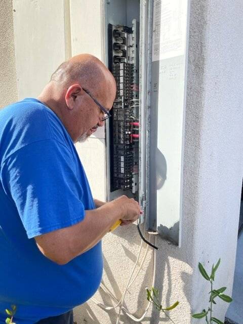

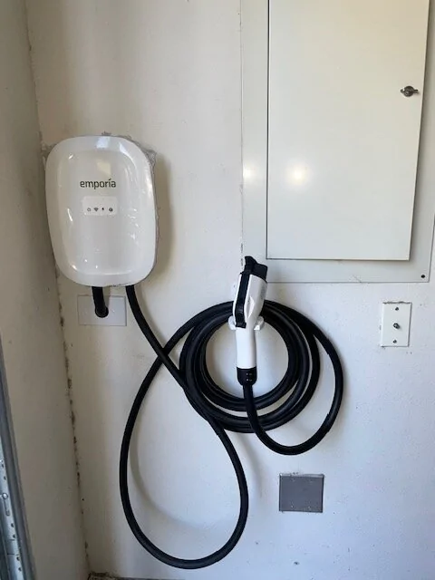

The only issue that might arise with some owners is the 100A breakers you would have to add in order to get 19kW (80A) to the battery using L2 (240V AC) in the panel.
My current EV charger at home is a L2 48A (11kW) w/ 60A breakers - that was a tight squeeze and now maxed out on my 200A service.
Electrician installing dual 60A breakers:

If I wanted to install a 19kW (80A) charger, I'd have to upgrade the panel to 300A service which I am not willing to do....
