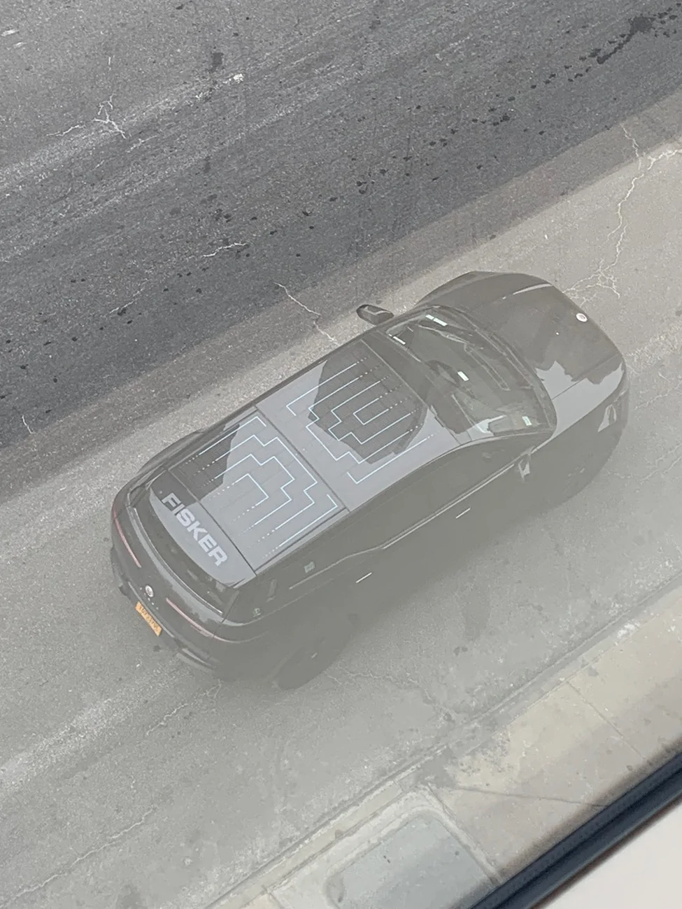

Fisker has implemented this on production Ocean models, don’t know how well it worked, but look where they are now. They claimed it can add up to 2000 miles of extended range over the course of a year under ideal sunny conditions e.g. FL

I think this idea has been brought up on almost every EV forum, but the answer is similar. Even on larger vehicles with room for a lot of panels, they don't provide enough juice to the battery to be worth the investment to integrate them with the vehicle. Even if the Fisker proposal were true, the math doesn't pan out:
2000 miles / 3 miles/kwh = 666 kwh per year * $0.18/kwh average cost in US = $120/yr return. That's in ideal Florida conditions. If you garage your truck, live somewhere that gets poor sun coverage, or have smaller/fewer/less efficient panels than the Ocean, that return plummets. Even under those perfect conditions, you're only getting about 5-6 miles per day of range. It can be expensive to implement panels like this for very little gain. I was surprised to see Fisker do that on the roof. I think it was largely just for show.
