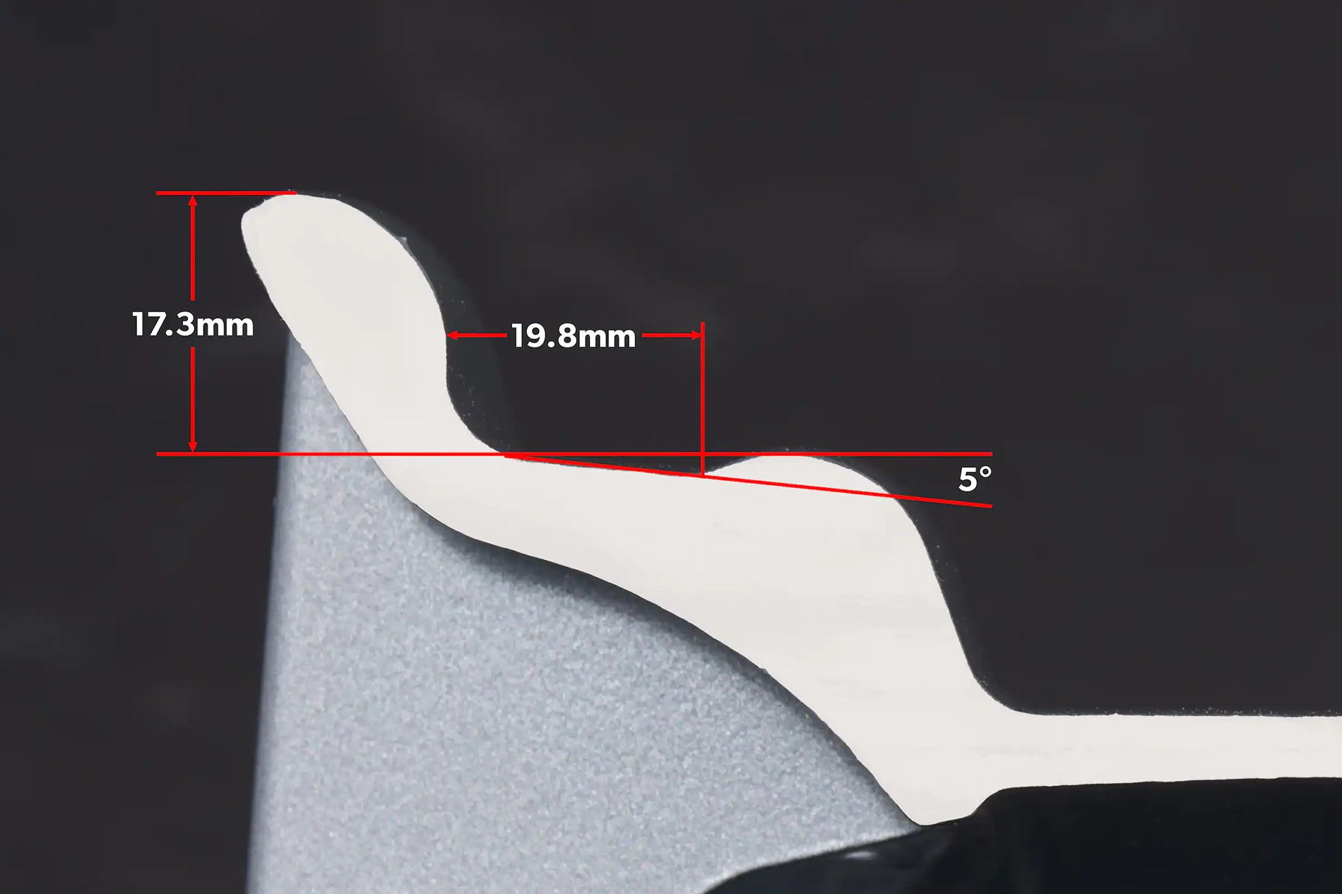

If you're going from the lip of the rim, you have to add about 35mm (depends a little on the wheel) to your diameter - 17" is the bead seat diameter, not lip to lip.

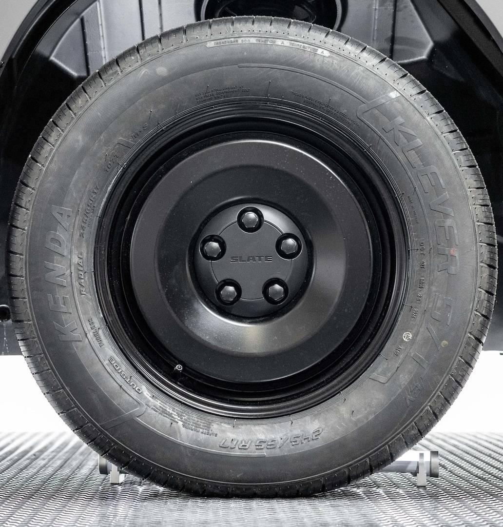

I used the "Blank Slate - Cutlight Detail" from the press kit which was pretty square to the wheel:
Slate Auto Pickup Truck Electric Windows Configuration. Blank Slate - Cutlight Detail
and measured 1187 pixel diameter at the lip (1182 horizontal, 1192 vertical, average to 1187) with 305 pixel BCD at the lug nuts. That maths out to 119.944mm before any massaging, close enough to 120 for me to be pretty confident that's the nominal size.

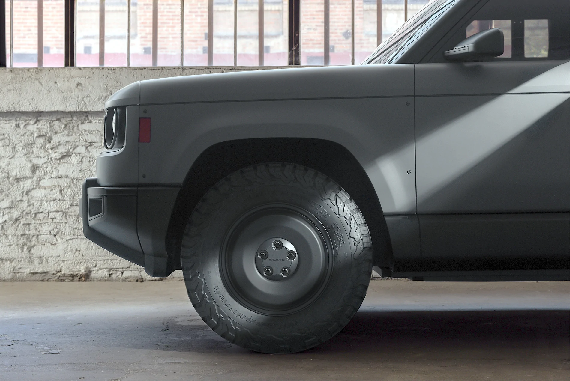

I checked against this image from this thread:
Slate Auto Pickup Truck Electric Windows Configuration. 36995-ecfc64f142eafde09b2522d0ec7382b0
The math on that one says 646 px lip diameter and 166 px BCD, which maths out to 119.951, again, close enough for me!
A few caveats: I don't think they'd change the hub pattern, but those are March and May 2025 images, not recent. And the first one is a BFG all-terrain tire, not a Kenda - BFG do make lots of 17" tires, including a 245/65R17. Most importantly, we don't know the offset, so we can't order rims yet! I suppose you could order wheel spacers for your widebody mod, but we don't know hub center bore diameter either. And, maybe most importantly, these are Slate-branded steel (steel appearance?) rims, not the aftermarket aluminum fifteen52 rims they've been using on the prototype trucks at events.
