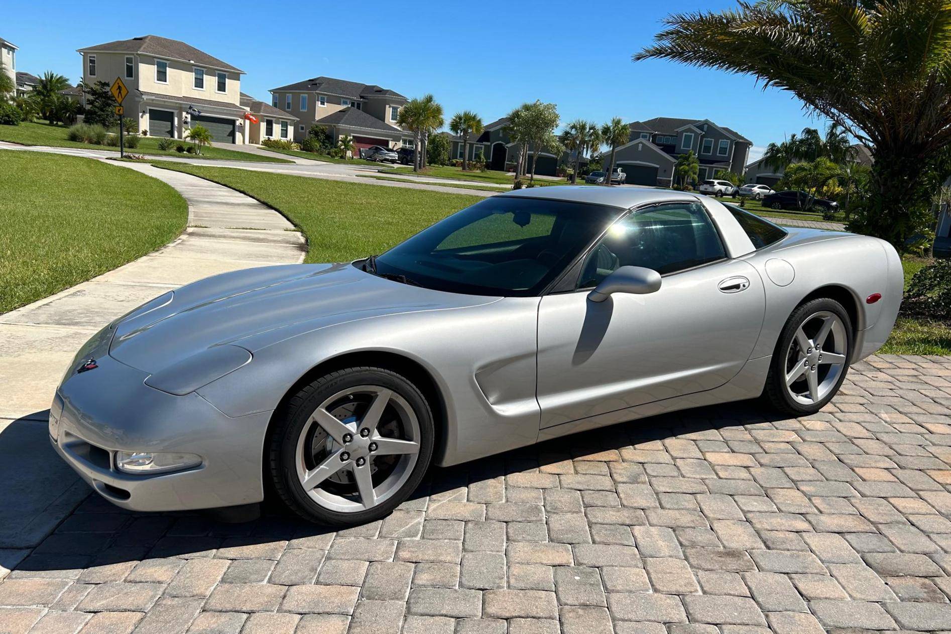

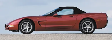

Just do drive the point that looks can be deceiving home for all the "that is standing straight up in the wind" aerodynamicists around here... These two cars have the same good (even by 25-30 years later) 0.29 drag coefficient: :surprised:

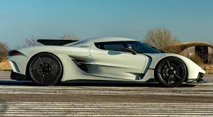

...And the drag coefficient of that much newer and super sleek looking Koenigsegg Jesko Absolut pictured in my previous post only achieves a mere 0.01 lower.
