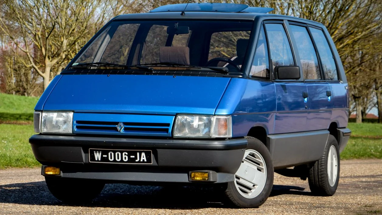

The 1988 facelift of the Renault Espace was championed by the press at the time for reducing the drag to .32. Touches like the flush mount side windows and low profile door handles do for drag reduction.

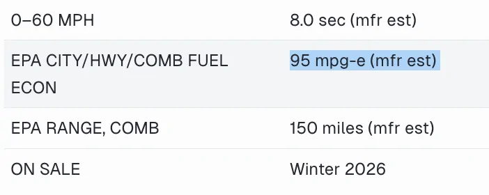

Until there's a standardized miles/kWh test routine, the best I think we can do it take the manufacturer's max advertised range / advertised battery size and see how it compares to other makes and modes using the same formula. The Slate's smaller battery is rated 52.7 kWh with an expected range of 150 miles. 150 miles / 52.7 ... That's the same as ~2.8 miles/kWh.
Using that simple equation, as I originally posted, I think the SLATE should o be better considering its smallish size and supposedly lighter weight with the smaller battery option . I acknowledge that trucks aren't the most aerodynamic designs, but EVs have been improving year over year yet the brand new SLATE falls on the crappy side of miles/kWh. SLATE should do better.

The EPA already specifies the same standardized test routines for EV's as they do for ICE's, to produce the MPGe rating. The standardized test routines are also used to determine a rated range, for equal comparison. Slate simply has not made it to this point in the process yet.

But that's the very problem I pointed out... We don't know the "manufacturer's max advertised range" because slate has not said what that is.
They have posted that the usable range is 150 miles. If that assumes working the battery from 80% to 20%, then it would mean the max range is actually 250 miles (giving 4.7 miles/kWh). But maybe they are making some other assumption in order to determine "usable range" we just don't know.

They've announced estimated Combined EPA Range.
The usable portion of the battery is the portion of the battery that hasn't been reserved (deliberately made unusable) in order to protect the battery's long-term health.
"Usable range" means maximum range the usable portion of the battery will allow you to travel.
