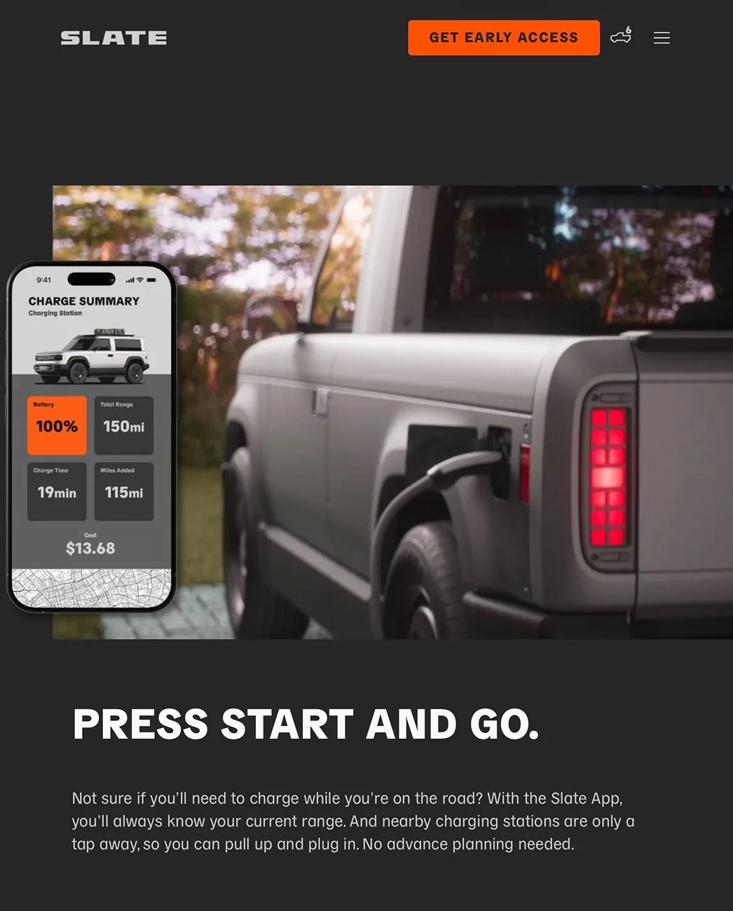

Do we have any knowledge about this yet?
Most vehicles on the market handle this with their integrated touch screen system, but the Slate does not have one of those.
I'm hoping it is not app based, as I pretty much refuse to install apps for things for privacy reasons.
https://www.slate.auto/en/charging
sure looks like an app
