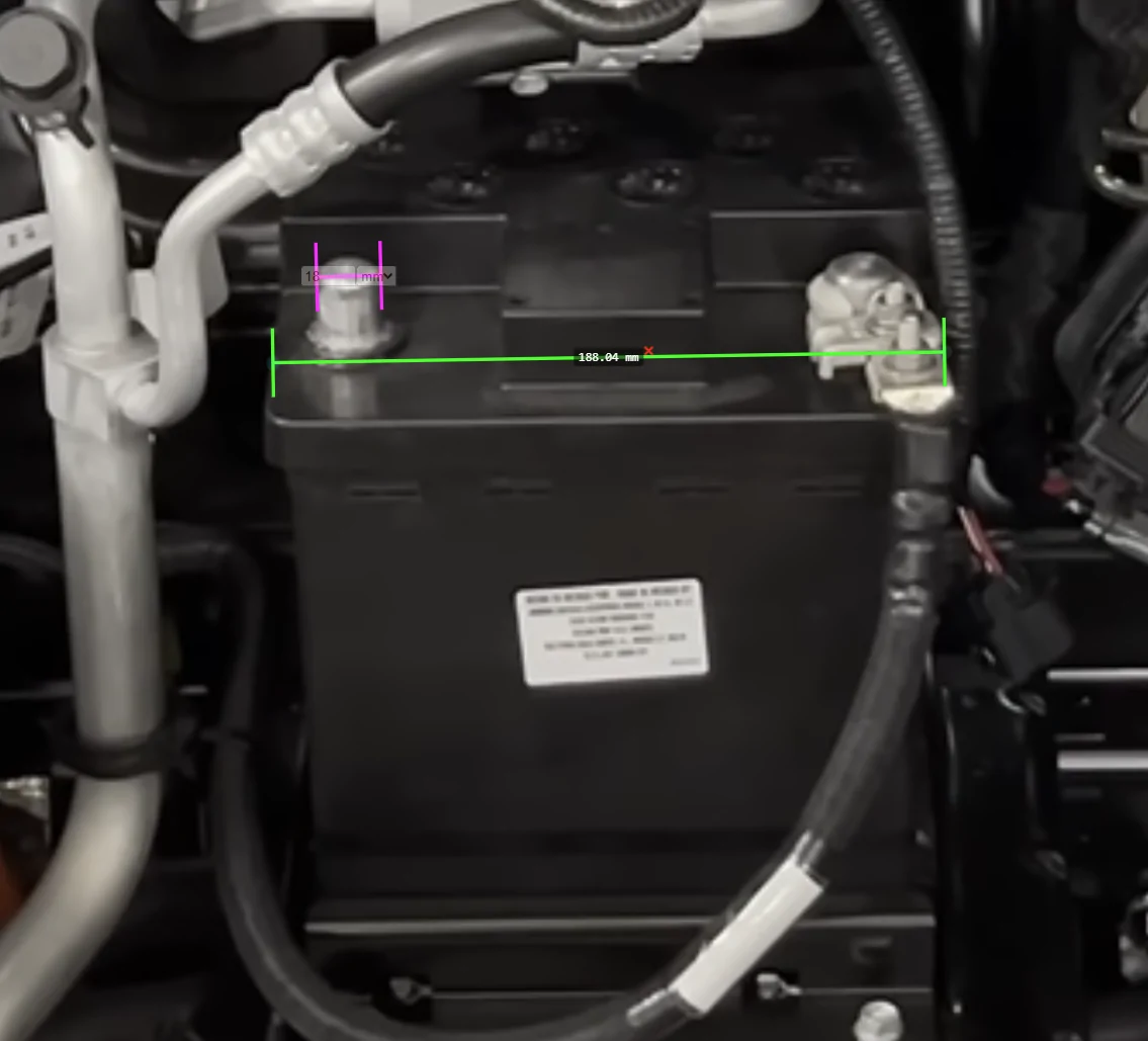

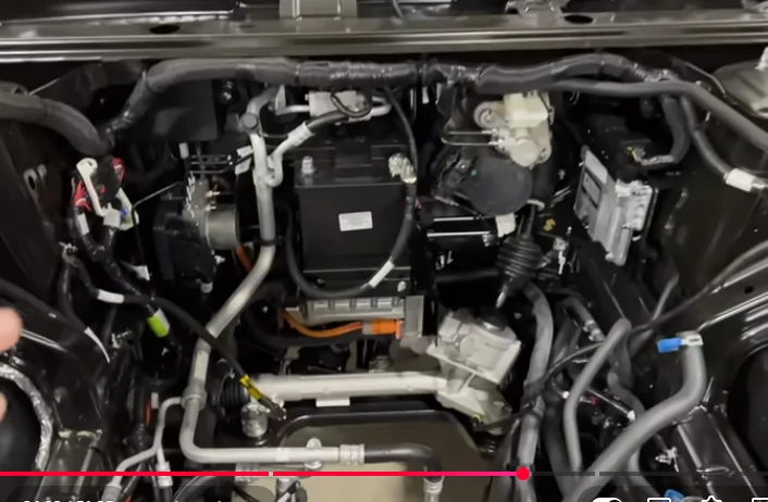

At least one of the recent review videos had a picture of the frunk with the 12V battery access door on the left side open. Anyone remember which video? From that we should be able to estimate the size of the battery. It looked reasonably large, something like a group H3 battery, 30-40 Ah rating? Sometimes possible to cram a slightly larger battery into the same space by sliding the brackets out or using lower profile terminals. (The MachE has an H3, but I've heard some people have slipped an H5, slightly longer, into the same space).

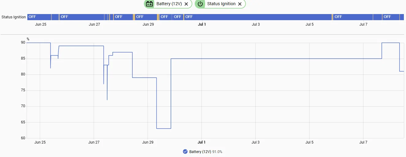

My MachE is riddled with always-on telematics so that the cell modem can wake up the car, and it recently sat idle for 2 weeks, and dropped 3% of 12V SOC, on a 35 Ah battery. That would be less than 1 mA of standby load (or the DC/DC turned on at some point during that time and it doesn't show up in my data).

Nice, that is a great shot of it. From the pixels, and making some assumptions, it really looks like an H3 or a Group 35 AGM battery, meaning 30-40Ah. If my measurements are off or that isn't the final battery, then it is at least something in that size range.

I think your conclusion might be right but your measurements might be off. The only group 35s I see are around 9 inches wide (228mm), depending on the brand. But I think the top post would be 0.625 or around 15.8mm. That should make your measurement on the width closer to 9in.

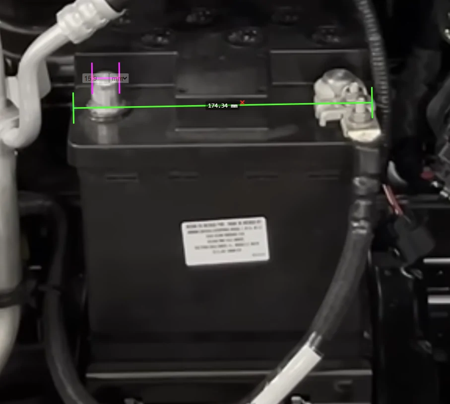

Good point, I think I had the wrong terminal top dimension. Tricky when they are tapered, and positive and negative are different dimensions. If the left post is negative (seems most common for H3 batteries), then the top is 15.9mm.
That gets me to a width of 174.3mm, which is very close to the 175mm width of an H3 AGM battery. So I'll revise my prediction to H3 AGM, 35AH, rather than a Group 35.

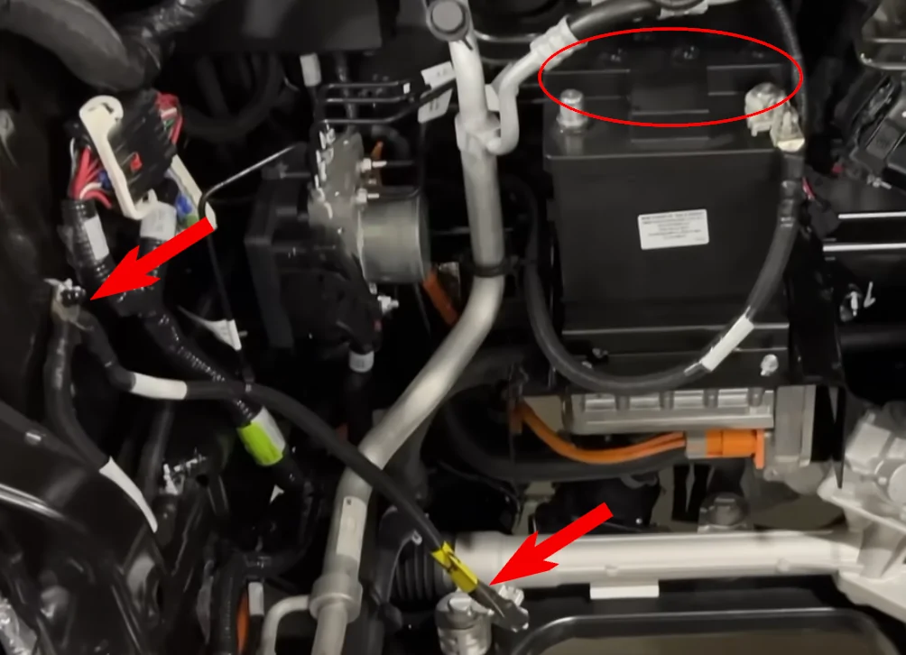

Stupid me, I thought that would make the width measurement wider for some reason. It's been a long day I guess.
I looked up some stuff and am going to confuse things. Sorry in advance!
Group 35 batteries use SAE terminals with the negative side being 15.9mm
H3 batteries use DIN Type A1 terminal with the negative side being 17.9mm
Your initial 18mm might have been right but it would still be close to an H3.
Aside from that, the top of that battery sure does look like an H3 with the T shaped raised part (circled). And for what it's worth, you're right about positive being on the right. The positive side has the terminal with bolts sticking up for a Hall sensor or whatever, plus this looks like the negative cable hanging there (arrows).
