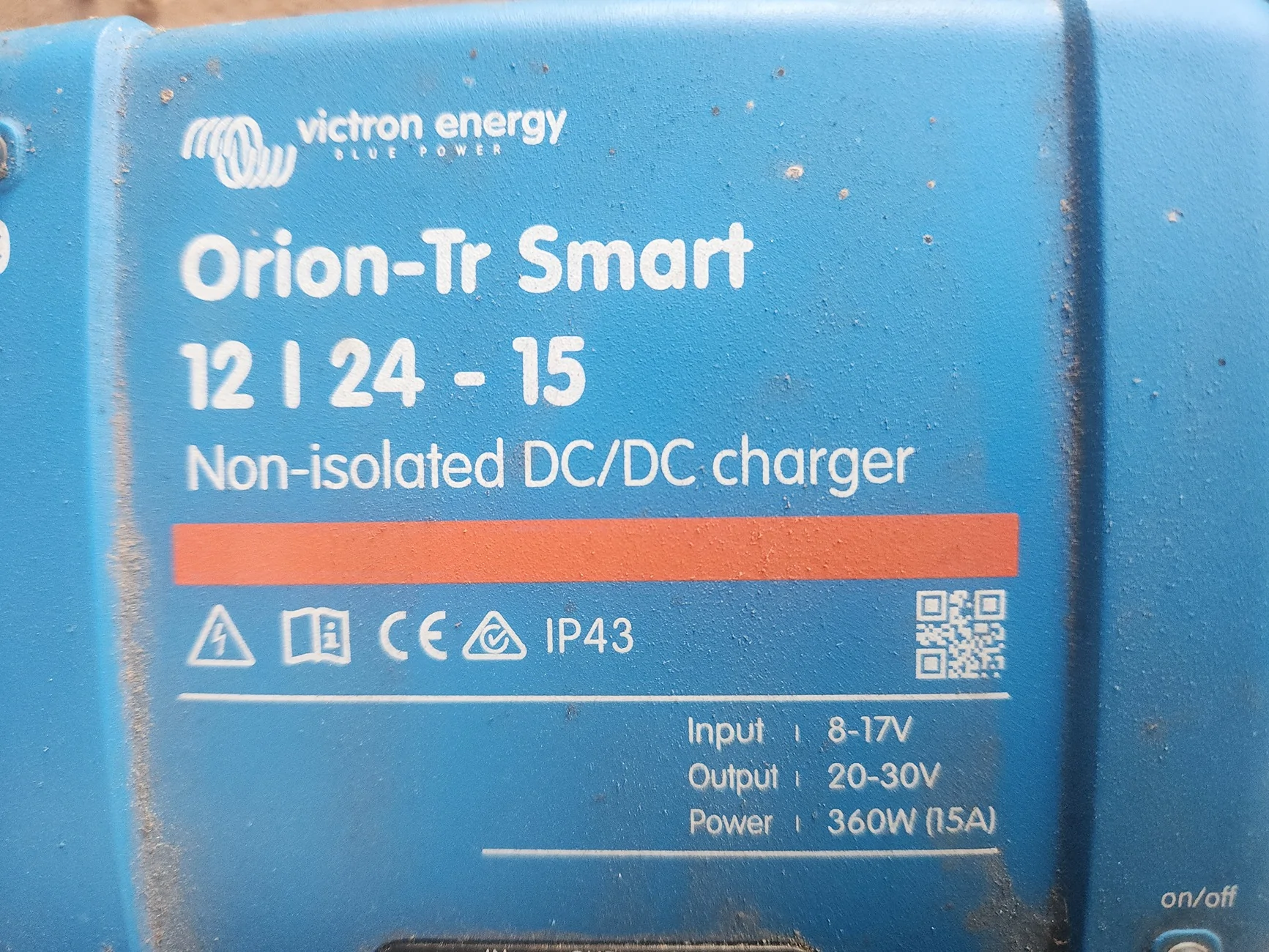

2 ways
1. A dc-dc converter, can be set to only charge by voltage level or from a switched 12v signal. Good for if you want to charge a lithium battery.
https://www.victronenergy.com/dc-dc-converters
This is the one I have, it's a 12to24v for my 24v system (inverter, fridge, ac).
