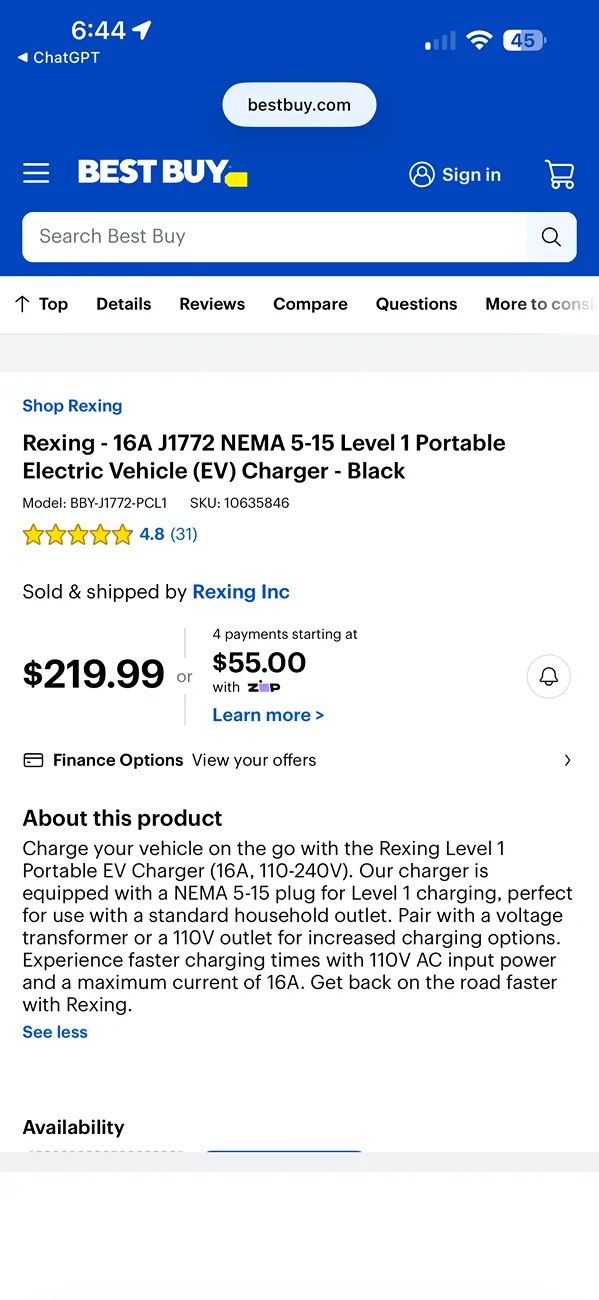

So far I haven't be able to find a L1 NACS EV Charger with a NEMA 5-20 Plug and will not limit the output to 12amps Max.

To answer your question, a 5-20 plug that will trigger a 16A rate is an option for a Tesla Mobile Connector (an EV AC charger is part of the car).
There are also cheap 120V/240V 16A “chargers” that ship with a 6-20 plug and adapter to 5-15.

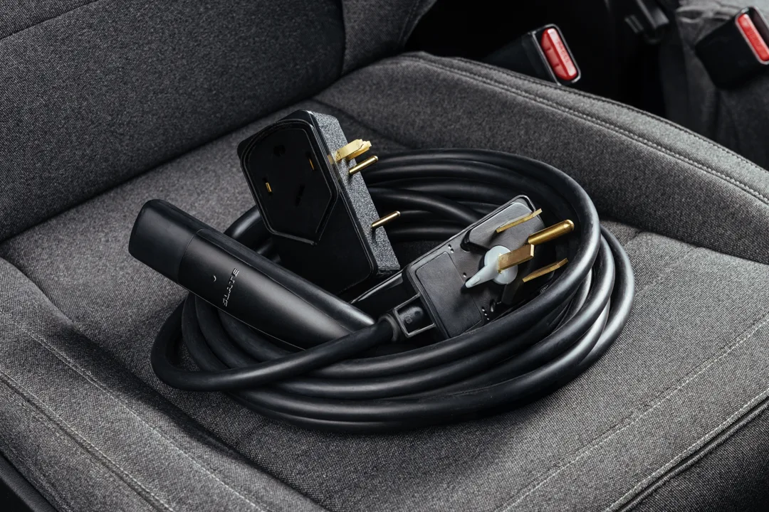

Slate's recent press release spec sheet says the onboard charger is an estimated "Level 1 AC, 1.9kW, 20-80% 17hr", which I believe translates to 16 amp on the truck's module. I don't know the details about their cable. This is on the website:
Slate Auto Pickup Truck Maxing Out L1 Charging the-blank-slate-modulesText_and_Media_-_1080_x_720__various_height__copy

Those 120V / 240V Chargers will limit the continuous current to 12 amps when it detects 120V.
