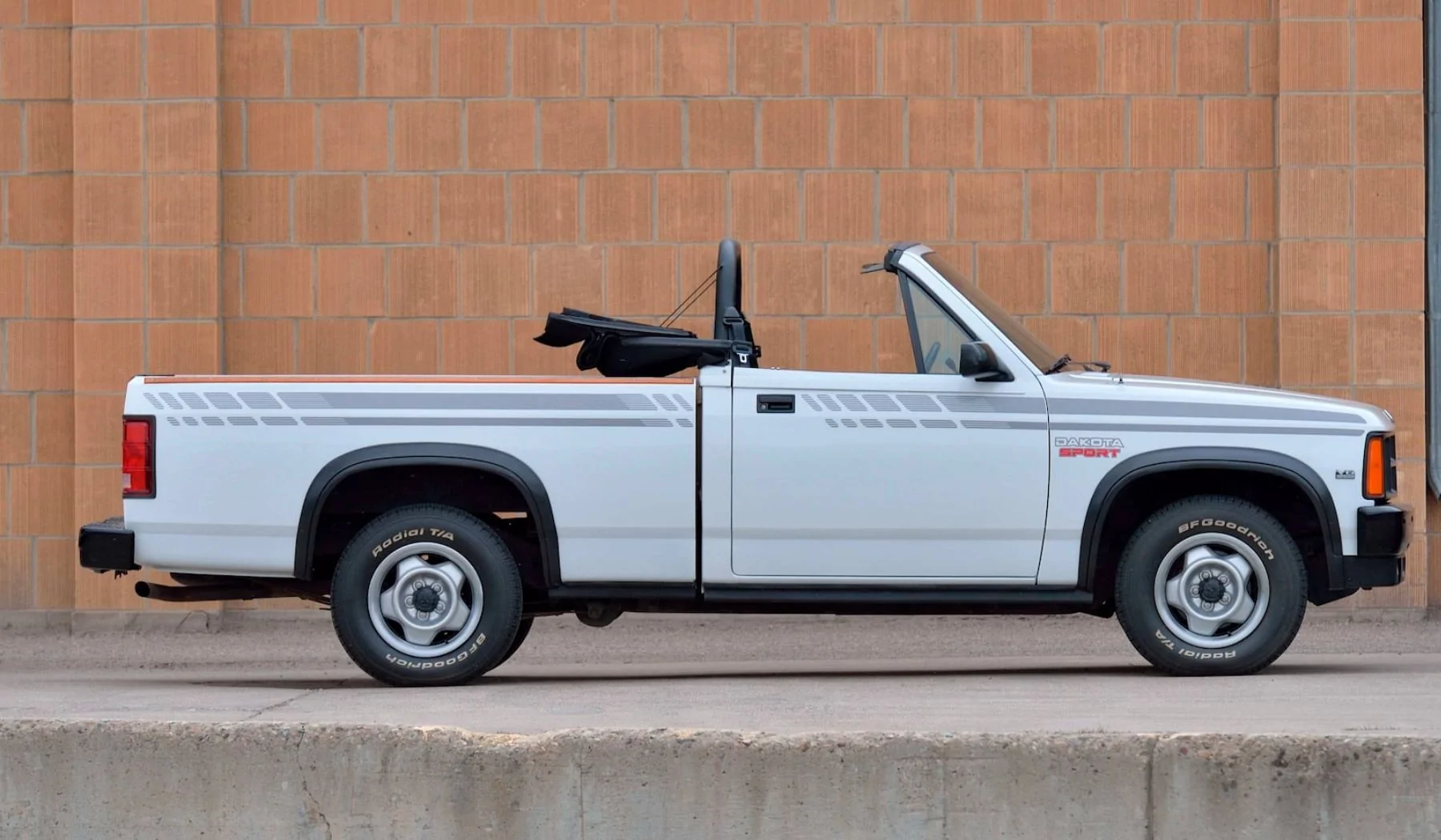

Those Dakota convertibles are pretty snazzy, I'd love to see a Slate in that style!

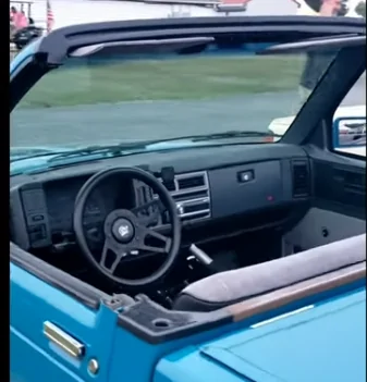

I had an S-10 converted. It was fantastic.
Part of the conversion was reinforcing the A-pillars.
Unlike a body-on-frame S-10, the Truck's cab's structure is part of the frame itself.

Edit:
This one's not mine, but it looks like it was converted using the same kit. I removed the sun visors for a cleaner look.
Slate Auto Pickup Truck Roadster pickup! S10_Convertibl
