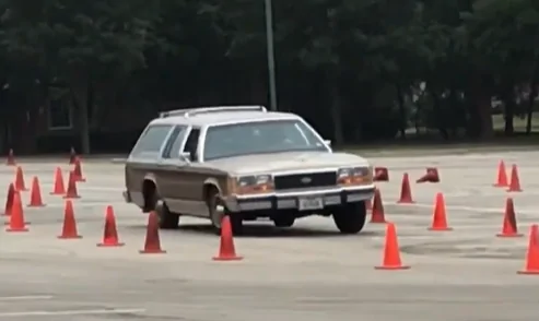

I'd absolutely do it, the Slate would be replacing my only proper autocrossing car so that's convenient.
I have done an event or two a few years ago. But never had anyone to go with. A group I'm in now is doing meets again and are trying to push me to take my Fit to it. They say it's a great candidate given the body rigidity, low ride height, and frontal/well distributed fuel tank location.
However, the most fun I ever had was taking the LTD to an autocross event. That car has earned its retirement now though!
