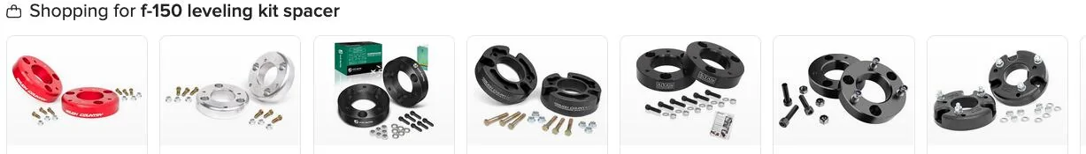

A pickup truck Leveling Kit (modest lift kit for the front suspension) is an inexpensive strut spacer that looks something like this:
Slate Auto Pickup Truck Suspension Poll: Lifted, Lowered, or Standard Height? Strut_Spacers
$42-$109
Remove the strut.
Attach the spacer onto the top of it.
Reinstall the strut.
Possibly get an alignment.

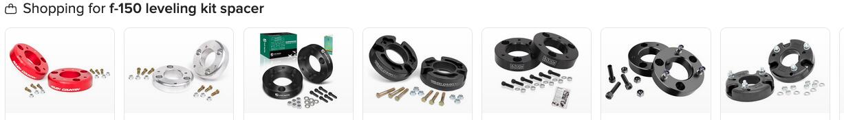

$42-$109
Remove the strut.
