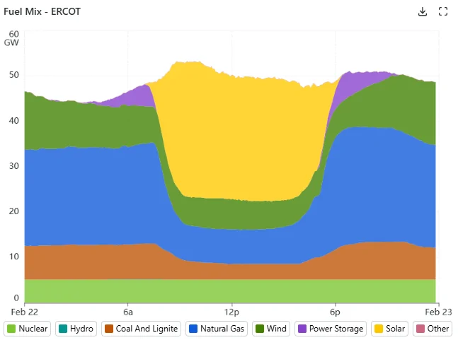

Yeah, California used to, until they switched to nem 3.0. Basically you want batteries with your solar now, to charge midday and discharge during peak hours. Get quotes from multiple companies, and be sure batteries are part of it.

Evidently I am not intelligent enough to understand how disincentivizing homeowners and businesses from installing solar will produce more clean energy, decrease our dependence on foreign oil and move us toward energy independence.
The problem is purely physics - CAISO already produces so much solar that during the daytime most of the year there is nowhere to put it all. They routinely go negative and export power to the neighboring grids when they can, but even that isn't always enough. Adding additional rooftop solar there is the right mindset, but without the addition of batteries, new incremental solar doesn't help. I know it is frustrating for homeowners, but there isn't really a way around the physics - load and generation must be matched 100% at all times.
Texas will be there in a few years, it is the second largest producer of renewables after CA, but a higher fraction of it is from wind power, so they can continue to take more rooftop solar for a bit longer. Many other parts of the country can take a lot more rooftop solar yet.
