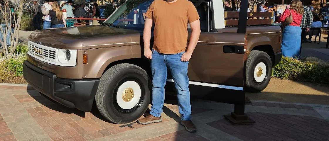

I took an IRL pic with the Slate at the Ft. Worth showing for just this reason. I looked at the pic and I'd estimate that the bed sidewall "reachover" height is about 45'' based on measuring the same pose from my elbow. For reference I'm 6'0 on the dot.
Slate Auto Pickup Truck Bed height from ground and Bed sidewall height 1781757560638-nn

Elsewhere on this forum there is a table posted with some dimension info - in that table the bed length with tailgate down is 81.6" (and the bed length is otherwise listed as 5' = 60") - so a sidewall height of 21.6" seems to be a reasonable assumption.
Edit to include thoughts on bed sidewall height from ground - the wheel diameter with the 17" rims and 245/65 Kenda Klever tires is ~29.5" - eyeballing the photo above from Luxrage this seems to confirm that the sidewall height from the ground is approx. 45".
Finally - math for the height of the truck bed above the ground yeilds about 23" or 24" (45" less 21.6").

Yep, based on what others have said here it appears that the bed height is going to be about 23" - 24", being a relatively short old fart that's important to me, don't want to be hoisting my bicycles up too far at my age. Thanks.
