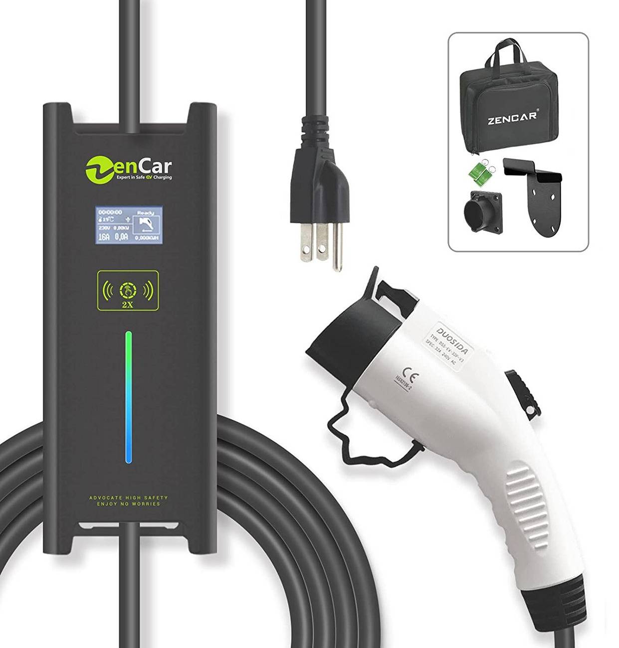

I've shown elsewhere on this forum my 6A/120V/720W "portable" solar setup (which ends up being closer to around 600W under real world conditions.) The EVSE I bought for that project is one of the Chinese-made Zencar units. The one I have allows 120V (level 1) J1772 charging at 6A, 8A, 10A, 12A and 15A . . .
https://evseadapters.com/products/z...ble-ev-charger-evse-with-timer-and-wall-mount

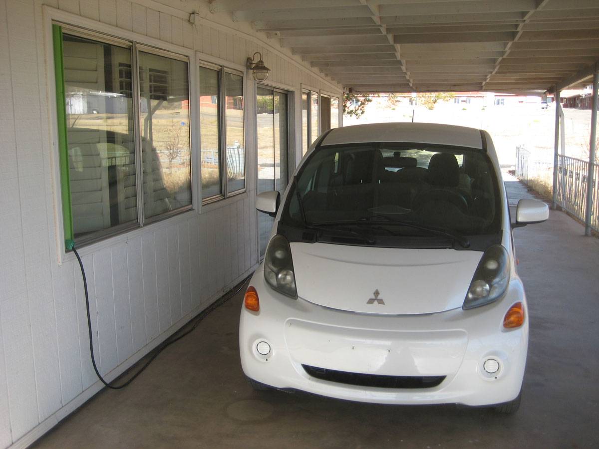

The carport at the house I bought last year doesn't have an exterior outlet. But I have numerous adjacent windows with several good unused outlets on the other side of the wall. So, I plug in there and pass the cable out a slightly open window. To weather/bug seal the window opening, I have a swimming pool noodle I've cut to length and a shop rag (matching green color, of course) padding the bottom of the opening . . .
Slate Auto Pickup Truck Will you be installing a Level 2 charger? BisbeeCharge_01_W
Most of the time, I'll schedule daylight charging sessions. And more often than not here in Arizona, it'll be sunny. With the PV panels on my roof and the EVSE set to either 6A, 8A or 10A, this translates using less electricity than my panels are producing. So, I'm essentially solar charging this way.
Even with a "big' battery" Slate, I'll probably continue charging like that on 120V. I'll just be plugging in more often (more days per week) to keep everything relatively topped off. A nicer 120V exterior outlet in that carport is certainly in my future, so I don't have to keep passing a cable through a window opening.
