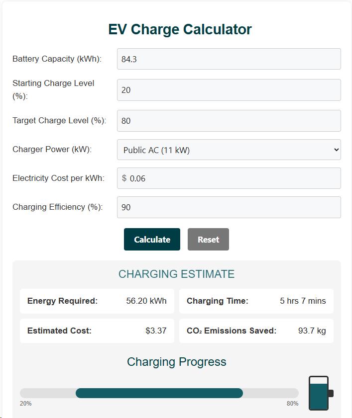

my power company will credit the cost of the charger but installation has to be done so whats that cost to run 220v from my panel, across my basement into the garage? if that costs $1,000 how long would it take to pay for itself
looks like about $3 per day IF it was charged from 20%-80% every time
if we charged just 4 days a week it would take 1.5 years aprox to pay for the install if it was $1,000 and on off-peak compared to regular power
so probably worth it to have it installed for off peak power for me
